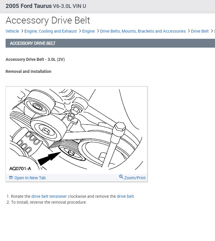

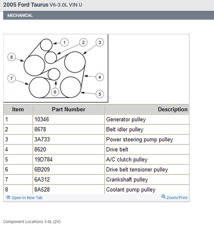

Serpentine belt installation.
Aug 10, 2022 at 9:22 AM
SQM
  • 6,383 POSTS
See attached for the belt diagram and replacement steps.
Here is a helpful guide:
Let us know of any questions.
