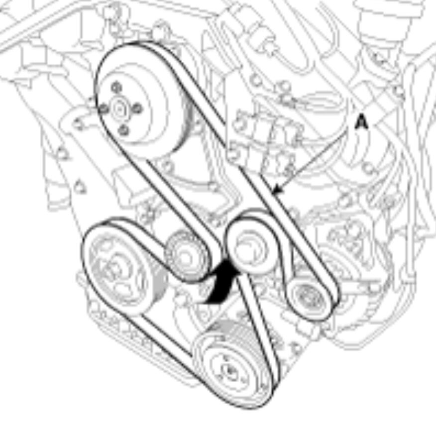

I need a Serpentine belt diagram.

This should be the 3.3 belt routing. That tensioner will fight you some. Using a long ratchet and socket can make it easier.
