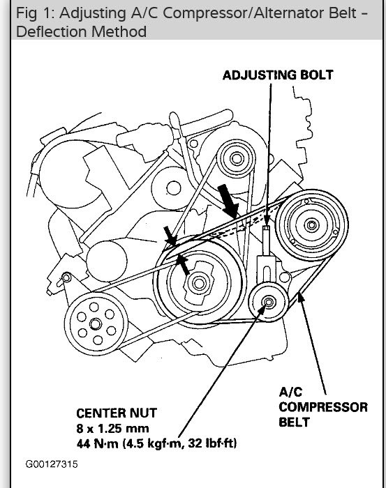

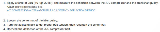

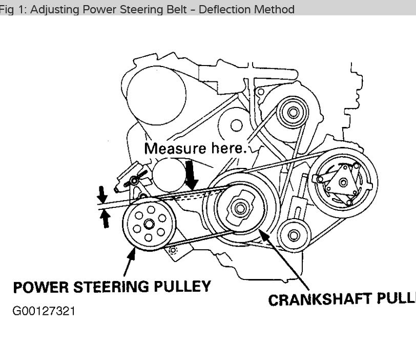

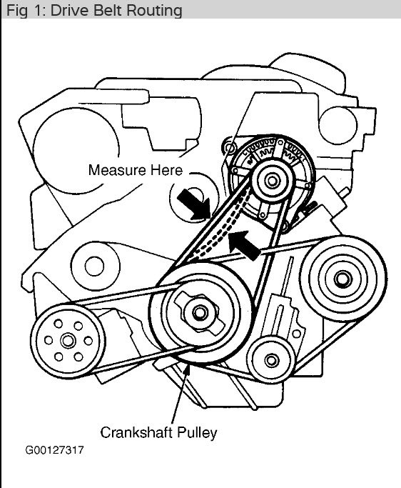

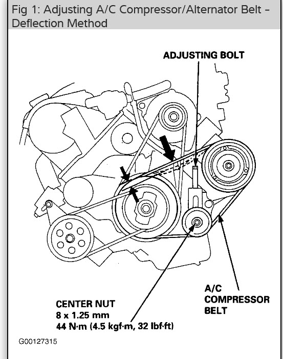

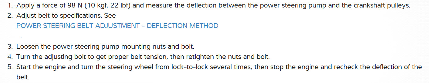

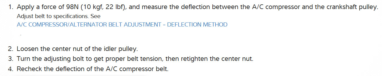

I need a diagram to install a serpentine belt and instructions.
Apr 26, 2017 at 12:46 PM
HMAC300
Experienced Mechanic
48,601 POSTS
see pictures for diagram adjustments etc.
