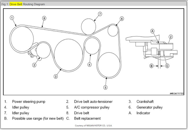

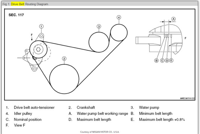

I need the diagram for the car listed above's serpentine belt and any advice or how to on replacement. Thank you!

Here is the procedure and the diagram of the belt routing. Please let me know if you need more information.

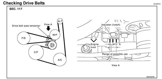

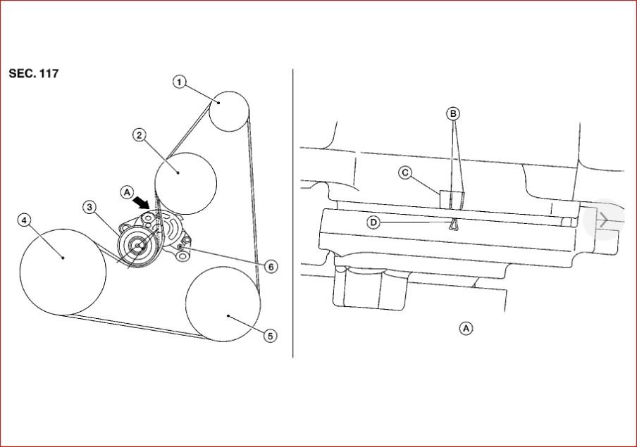

Is the drive belt routing for 2010 nissan altima?
Sep 10, 2020 at 5:04 AM (Merged)
  • 75,988 POSTS
There are two different engine in this car so here are both diagrams and a guide to help you change the belt out below.

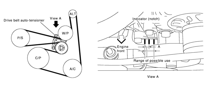

I need a diagram on how to put the belt on.
Sep 10, 2020 at 5:05 AM (Merged)
WRENCHTECH
  • 20,760 POSTS

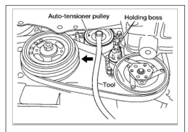

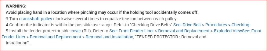

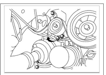

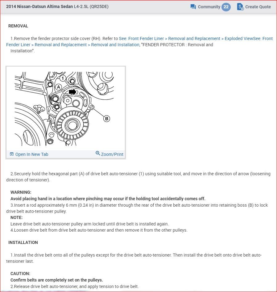

Here is how you install the serpentine belt. Check out the diagrams (Below). Please let us know if you need anything else to get the problem fixed.

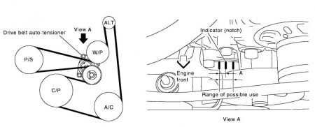

I need the diagram for a 2005 Nissan Altima 2.5 S
  • 55,748 POSTS
Hello, Here is a guide to show you what you are in for when doing the job. https://www.2carpros.com/articles/replace-serpentine-belt
https://images.2carpros.com/forum/automotive_pictures/12900_db_3.jpg
https://www.2carpros.com/diagrams/nissan/altima/2004 Check out the diagrams int he link above Please let us know if you need anything else to get the problem fixed. Cheers, Ken

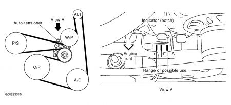

2002 Nissan Altima 4 cyl Front Wheel Drive Automatic 96k miles
my serpertine belt is vibrating coming off the alt and making noise. when i lube it a little it stops so i m assuming that it needs changing what is the belt route and do i need to remove the top mount.
MHPAUTOS
  • 31,937 POSTS
Hi there, Belt set up as per pic, Mark (mhpautos)
