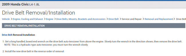

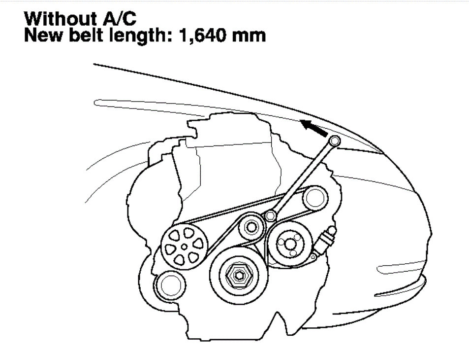

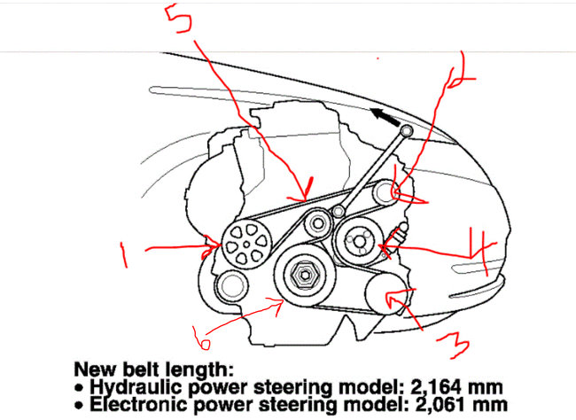

The components are not identified in the attached directions, but it does show the belt routing diagrams for three different possibilities. The directions are for removal and replacement.
I tried my best to place a number on each component. They identify the following:
1) Power steering pump
2) Alternator
3) A/C compressor
4) Water pump
5) Belt tensioner (automatic)
6) Crankshaft pulley
Note: Pic 2 has the same components minus number 3, the A/C compressor. This pic is for a vehicle without air conditioning.

Pic 3 are the directions for removal and replacement. They are vague.

I hope this helps. Sorry about the sloppy writing in pic 1. LOL I tried.
