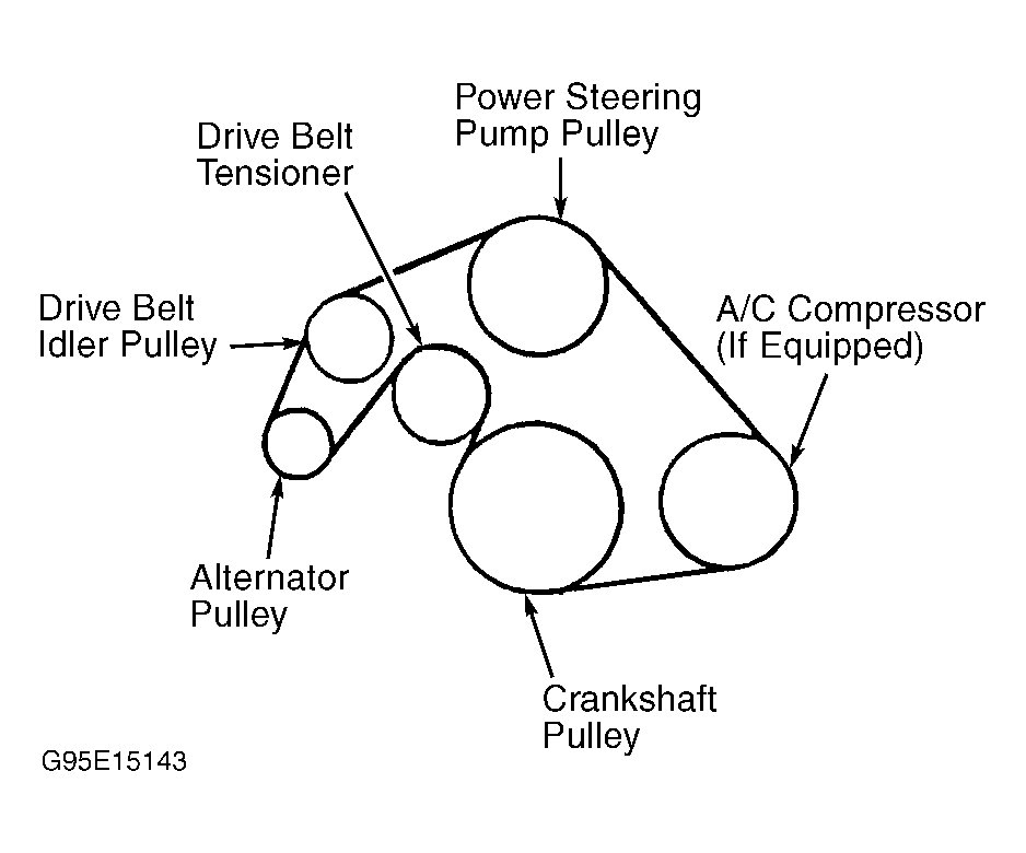

Do you have or know where I can get the serpentine belt diagram for a 98 Ford Contour?

Take a look at the attached picture below (click on it to make it larger)
