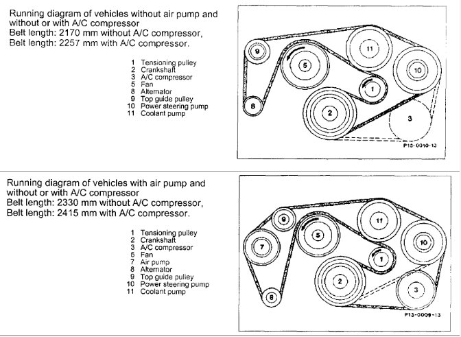

how does the serpentine belt go on?

There are various versions, with and without air pump, with and without A/C compressor.
Please see image below.
How to replace belt:
A good article:
https://www.pelicanparts.com/techarticles/Mercedes-W124/30-ENGINE-Drive_Belt_Tensioner_Replacement/30-ENGINE-Drive_Belt_Tensioner_Replacement.htm
Cheers, Boris
