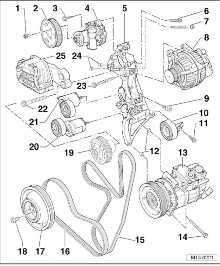

I'm trying to replace my serpentine belt. I cannot find the exact diagram needed. The belt fell off before so I couldn't retrace the setting. Please help.

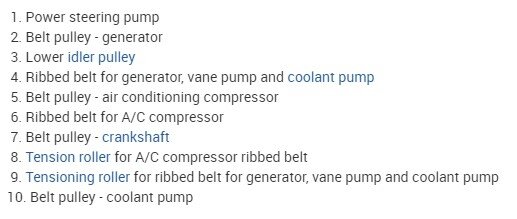

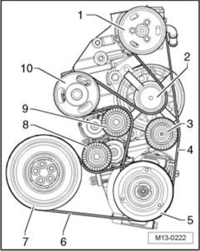

This should be the diagram for both belts. The outer belt goes from the crankshaft to the A/C pulley. Then the belt that powers all the rest drives off of the A/C pulley. If the belt fell off, then I would look for a reason that it came off. Could be a bad tensioner or damaged accessory item. Then replace the belts.
