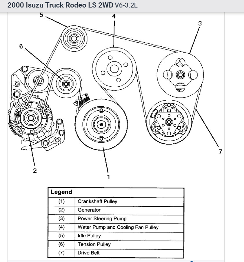

looking for a serpentine belt routing diagram for my vehicle listed above, just can't seem to find the right layout.

Here is a generic guide to help you change the serpentine belt out with the belt diagrams and routing in the images below:
Image (Click to enlarge)

thank you so much, that's perfect. :)
