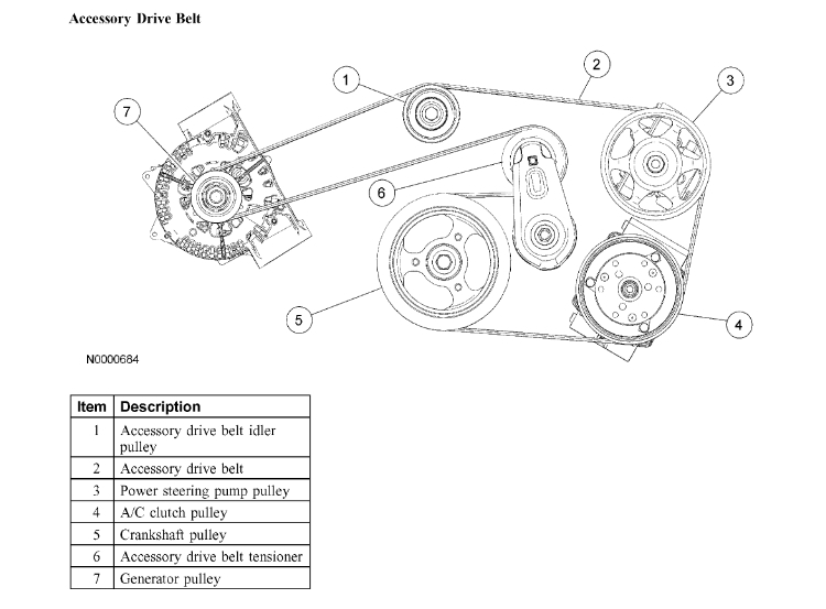

I need a serpentine belt image configuration for my vehicle listed above 3.0l v6, so I can properly install a new serpentine belt.

I looked through my manual and found very little. I did find the accessory drive belt, but it is somewhat vague. However, it should be correct.
Take a look at the pic and let me know if it helps or if you have questions.
See pic below.

I eventually located the proper configuration before your generous reply, and, with much additional help from Ford Motors in Astoria Oregon, I was able to install belt...
Your image is correct!
Thanks again. Now we'll see if the original cause of problem may be a sticky A/C Compressor pulley, which might have resulted in belt overworking, and eventual breakage?
I hope not? After installing a new serpentine belt, everything is working fine! God was gracious!

You are very welcome. I'm glad to know you got everything together. If the A/C compressor is causing the issue, chances are you will hear a belt squeal. If it has too much resistance or locks up, you should know.
