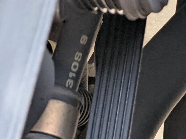

Hello Ken and company, this is Dan again. I've been having this chirping sound coming from under the hood and it only happens in the morning and afternoon after work. I start up the vehicle in the morning, drive down like a block and then it starts chirping and after driving a couple blocks it goes away. Then in the afternoon leaving work the same thing. I could hear it while it was idling. The chirping sound will skip, and my thought process was either it's a serpentine belt, but the inside of the belt looks fine or one of the pulleys is going bad. I read one of your other comments relating to this as far as shooting some water on it so I'm assuming if I squirt some water and the sound goes away it's the belt, please advise thank you!

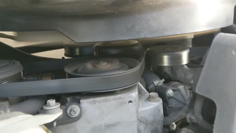

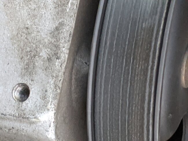

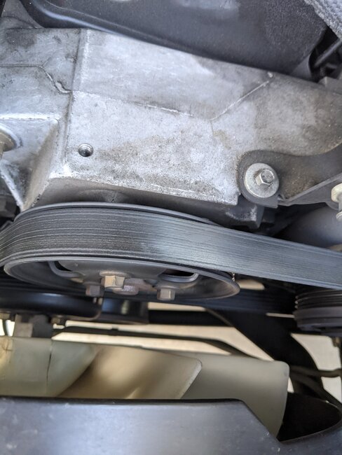

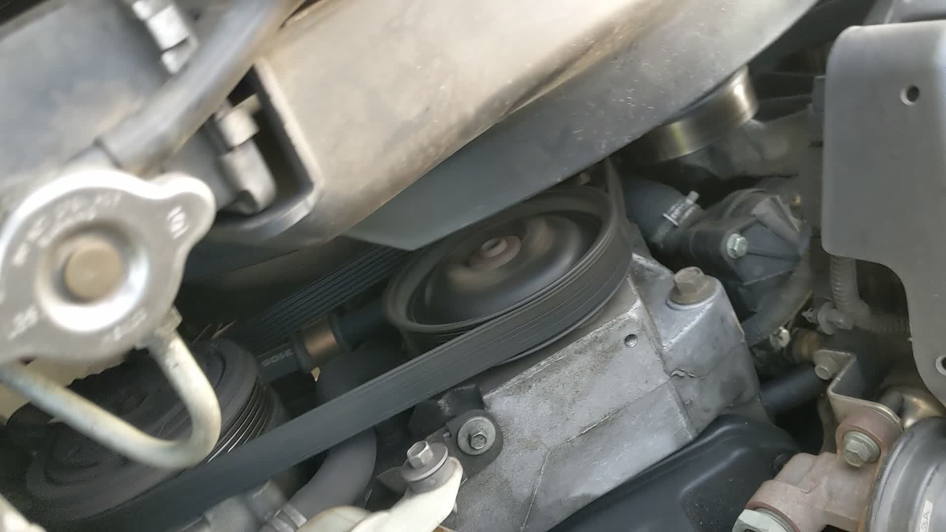

Hi, I took a look at the belt this morning before I started it, I didn't see anything with on it and I included three pictures of the outer and inner serpentine belt. I didn't put any water on it and when I started it and started chirping and then by the time I got down the street a couple blocks it went away again. I added a video hopefully it plays. Thanks

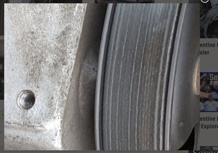

I certainly hear it. Try a couple things for me. When you hear the noise, turn on as many electrical components as you have. For example, turn the headlamps on, the blower motor on high, the A/C, wipers and so on. The added load on the alternator should make it change in pitch. Also, try the water test.
Also, how old is the belt? The ribbed portion looks great, but the flat section appears to have a lot of wear marks. I attached the pic below that you sent and I'm referring to.
See pic below.
