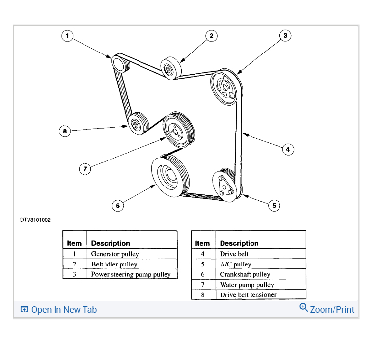

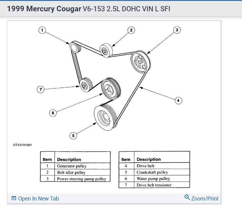

Need proper routing of the belt bypassing the AC pump.
Dec 28, 2022 at 5:41 PM
  • 55,721 POSTS
You can just get a drive belt that is for your car without A/C. here is the belts routing for both AC and non-AC engines. Check out the images (below). Please let us know if you need anything else to get the problem fixed.
