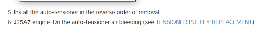

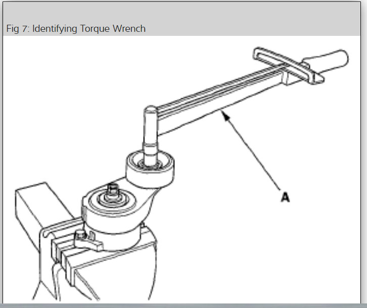

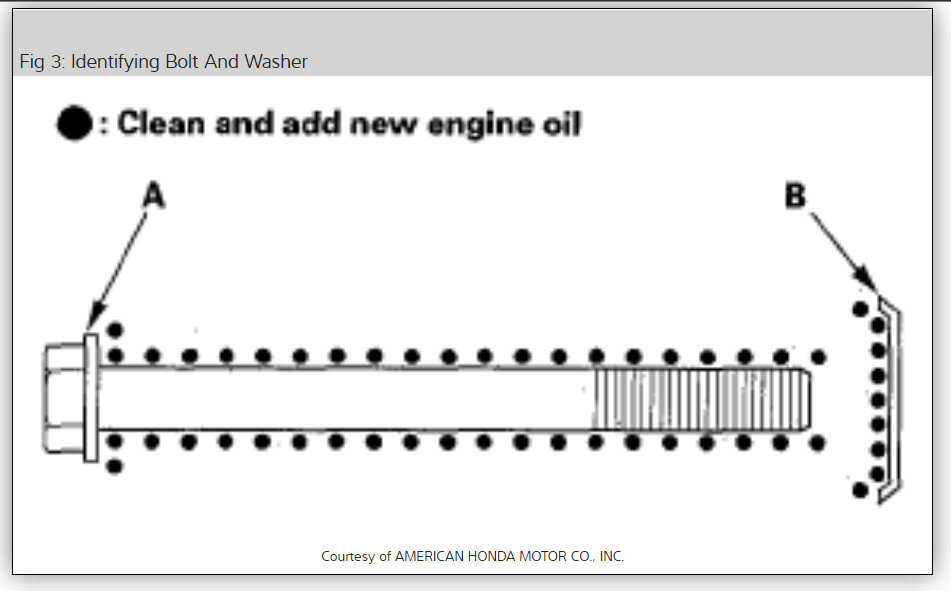

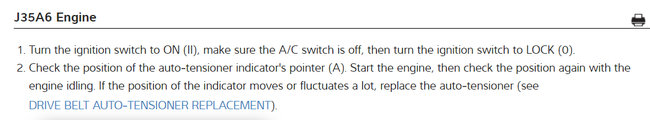

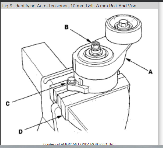

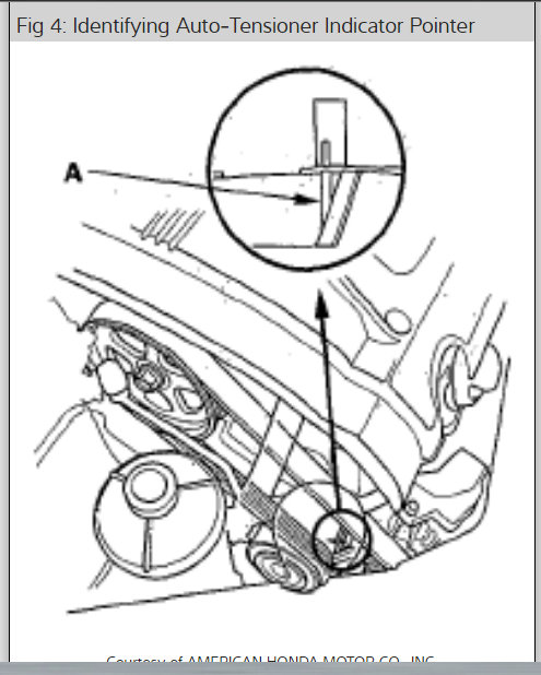

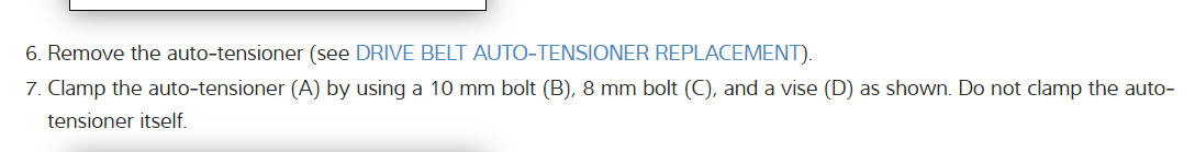

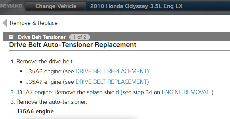

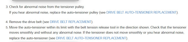

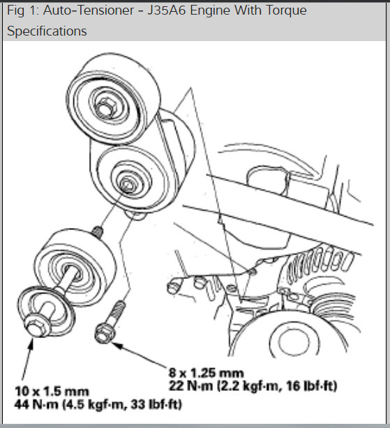

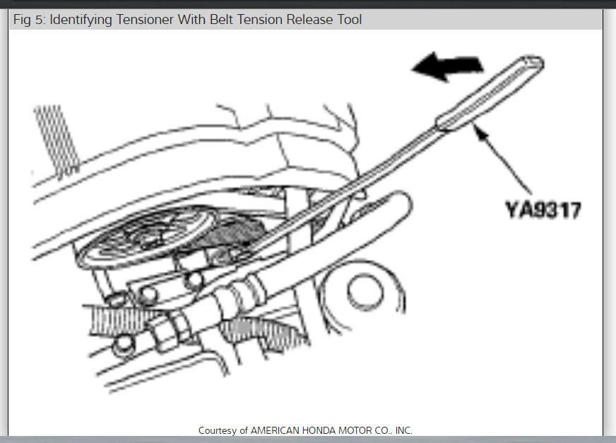

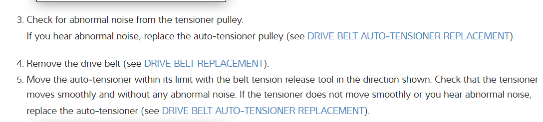

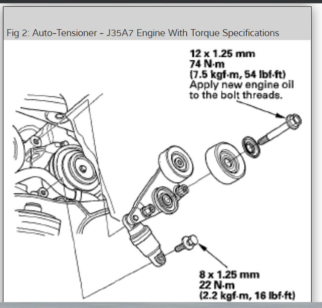

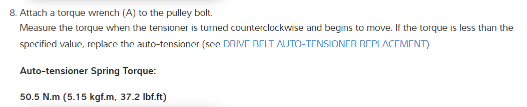

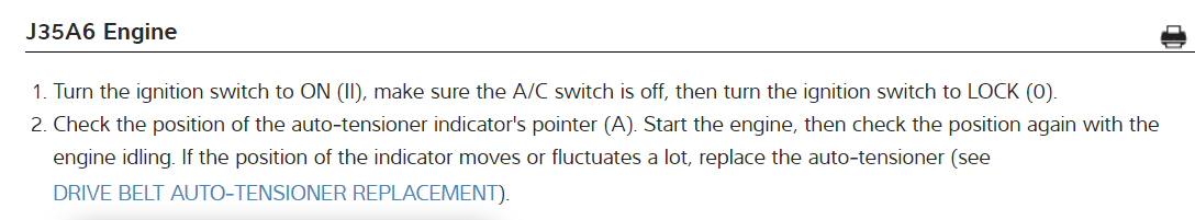

Are you sure that the proper tensioner was installed. There are two different tensioners options available for your engine. I have included instructions for the removal and installation of both tensioners as well as the correct torque specs for the bolts in the diagrams down below. Please go through this guide from the vehicle's manufacturer and get back to us with what you find out.

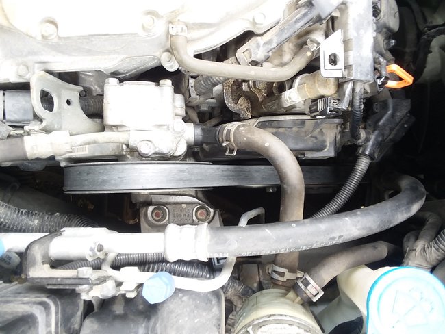

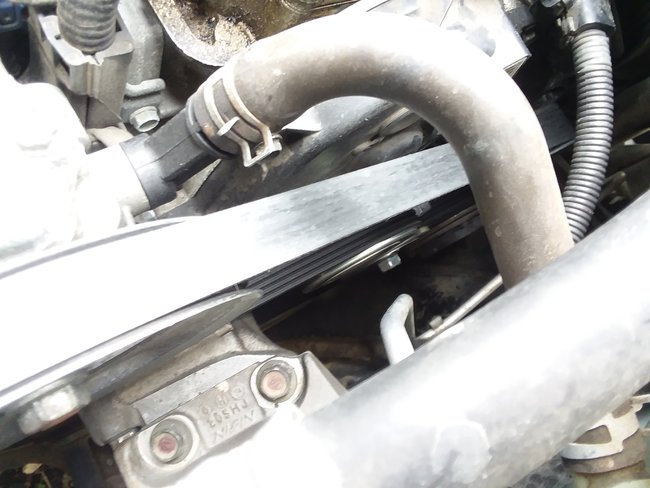

Hard to get a good picture, but by looking at it it looks in line correctly. Also on the forums I've been reading nothing is said about any kind of spacer. Talk to a few other mechanics and they've never heard of spacer for serpentine tensioner.
Apr 11, 2019 at 5:40 AM
The pulley under the power steering pump is the tensioner, I assume.
It is sticking out too far. It is not the same distance as the other pulleys.
No, I have never heard or installed any spacers either.
Remove the bolt and the pulley and see if there is anything behind it. It should seat back further.
Apr 11, 2019 at 5:55 AM
