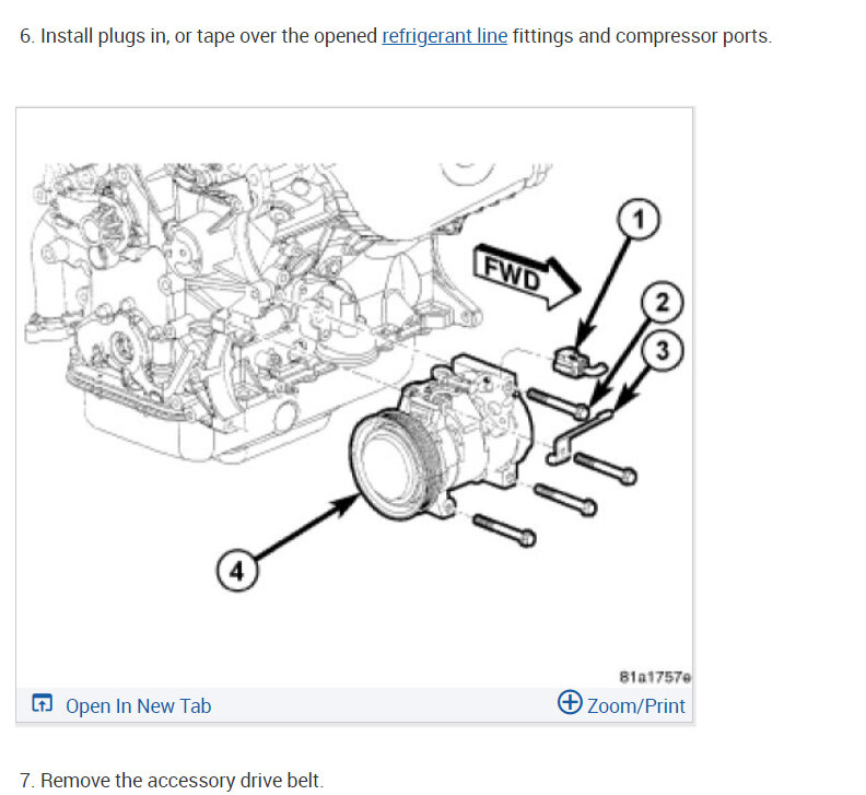

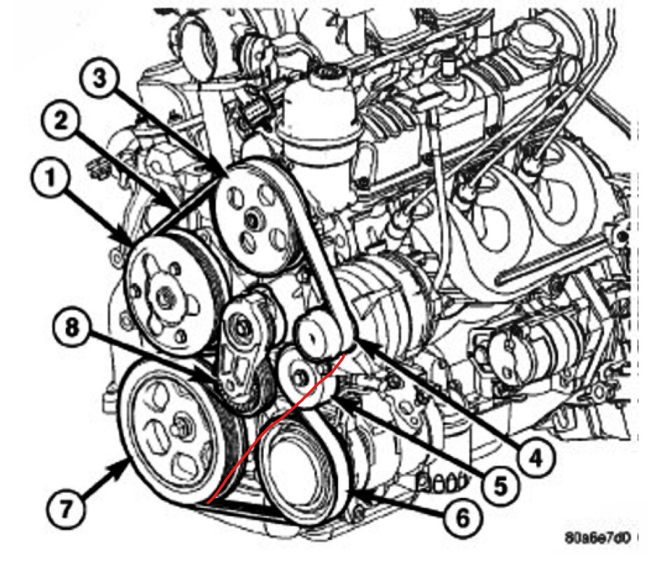

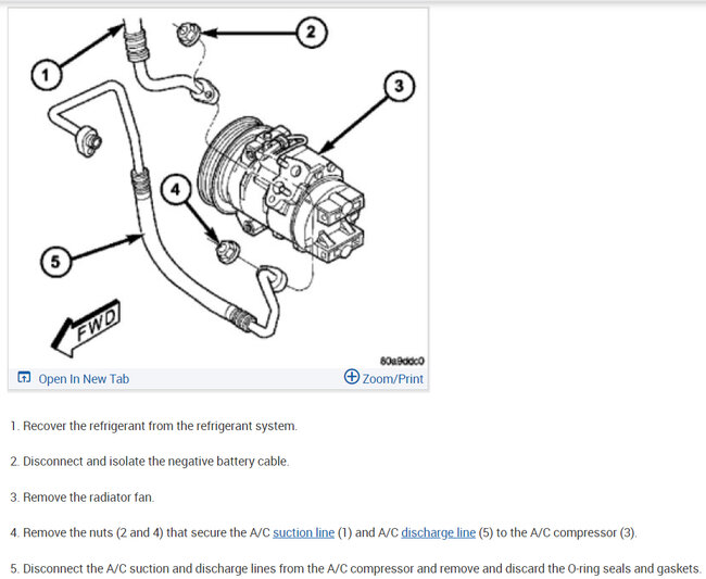

I need to know how to route my serpentine belt bypassing the A/C unit on the vehicle listed above.
Jan 30, 2024 at 6:05 AM
  • 55,433 POSTS

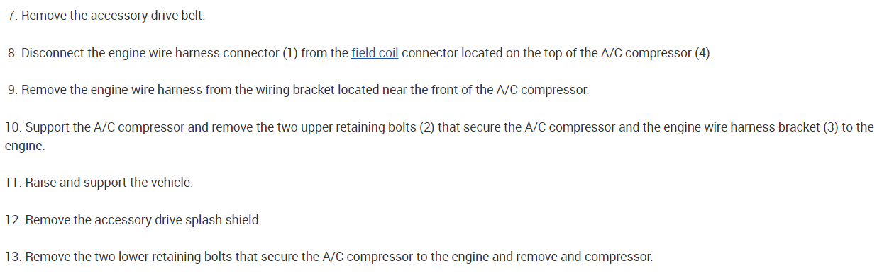

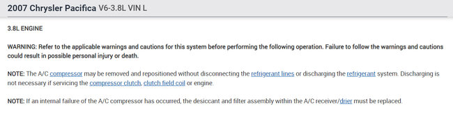

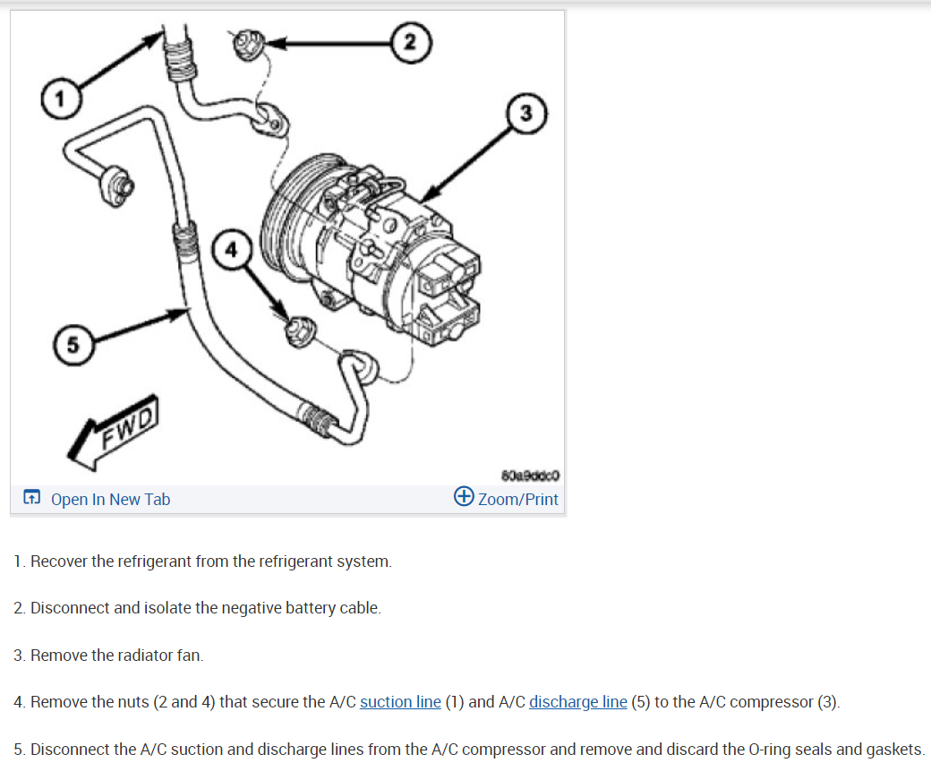

To have the belt work you will need to remove the A/C compressor and the idler pulley right below the alternator. Then just get few belts shorter than what the book calls for and do some trial and error. Here is how I see the belt routing to work, and I have left how to remove the A/C compressor as well and how to discharge the system which you must do beforehand. You can take back the belts that don't fit and get your money back.
https://youtu.be/4EqdrBVb0sY?si=-Vq2h5IvV8tXwxEr
Check out the images (below). Let us know if you need anything else.
