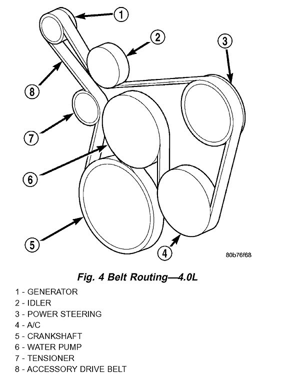

Serpentine belt routing diagram needed
2004 JEEP GRAND CHEROKEE
195,000 MILES • 4.0L • 6 CYL • 2WD • AUTOMATIC
TRISHA CORNELL
Can't find the correct diagram for the serpentine belt.

Here's from the service manual:
REMOVAL-4.0L ENGINE
NOTE: The belt routing schematics are published from the latest information available at the time of publication. If anything differs between these schematics and the Belt Routing Label, use the schematics on Belt Routing Label. This label is located in the engine compartment.
CAUTION: DO NOT LET TENSIONER ARM SNAP BACK TO THE FREEARM POSITION, SEVERE DAMAGE MAY OCCUR TO THE TENSIONER.
Belt tension is not adjustable. Belt adjustment is maintained by an automatic (spring load) belt tensioner.
1. Disconnect negative battery cable from battery.
DIAGRAM 1
2. Rotate belt tensioner until it contacts its stop. Remove belt, then slowly rotate the tensioner into the freearm position. (Fig. 4).

1. Check condition of all pulleys.
CAUTION: When installing the serpentine accessory drive belt, the belt MUST be routed correctly. If not, the engine may overheat due to the water pump rotating in the wrong direction (Fig. 4).
2. Install new belt (Fig. 4). Route the belt around all pulleys except the idler pulley. Rotate the tensioner arm until it contacts its stop position. Route the belt around the idler and slowly let the tensioner rotate into the belt. Make sure the belt is seated onto all pulleys.

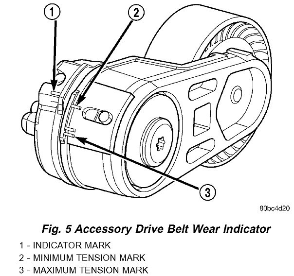

3. With the drive belt installed, inspect the belt wear indicator (Fig. 5). On 4.0L Engines, the indicator mark must be between the minimum and maximum marks. If the measurement exceeds this specification replace the serpentine accessory drive belt.
