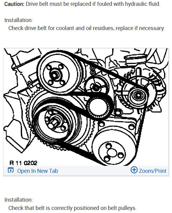

I shredded the serpentine belt on my vehicle listed above 325ci. I just got the car off a buddy, and he couldn't remember what all tools and sizes I would need to remove the fan and change out the belt itself. I've looked online for diagrams of how the belt goes and for tools needed and the o lyrics thing I can find on Google are diagrams and tools needed to do the same job but on a e46 model of the same year.

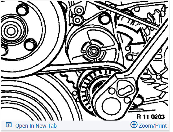

The tensioner bolt head should be 15mm or 16mm. Here is the belt routing which can be confusing if you don't have a picture of the belt beforehand. Check out the images (below). Let us know if you need anything else.
