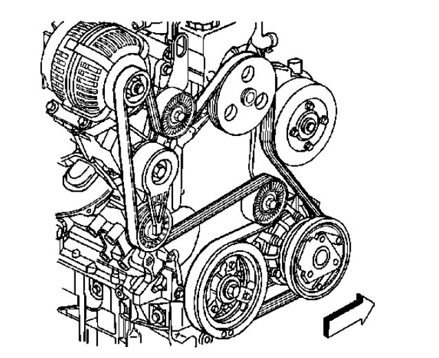

Diagram of how the serpentine belt loops through the engine needed?

I just need a diagram of how the serpentine belt loops through the engine. I’ve search the Internet and cannot find a picture anywhere.

I went through two manuals before I could find one. LOL I attached a pic below. See if the pulleys seem to match what is on your vehicle.
The arrow in the pic simply indicated toward the front of the vehicle.
Let me know if this helps or if you have questions.
See pic below.
