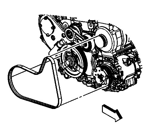

My friends car and she needs a diagram of how to replace serpentine belt. Any help is appreciated! Thanks, Carrie

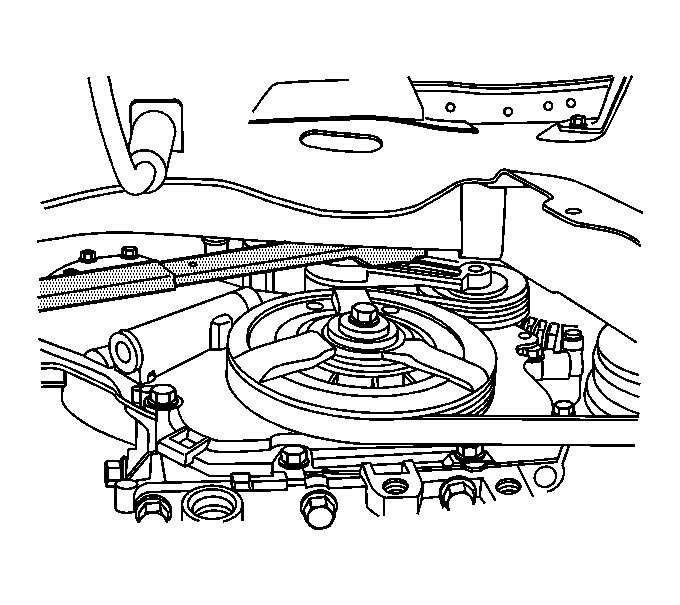

Your nomenclature for your vehicle was kind of vague.
I looked up the belt for both engine sizes (2.2L and 2.4L).
It looks like the routing is the same for both engines, these same two diagrams appeared in both of my look-ups.
I posted this out of our "Repair Guides" it may help.
There are a few more related guides (top right of our pages is "Repair Guides") Look in the "engine" section. Here is a quick link to all of the guides:
https://www.2carpros.com/articles
Below are the two diagrams.
Let us know if this was helpful.
