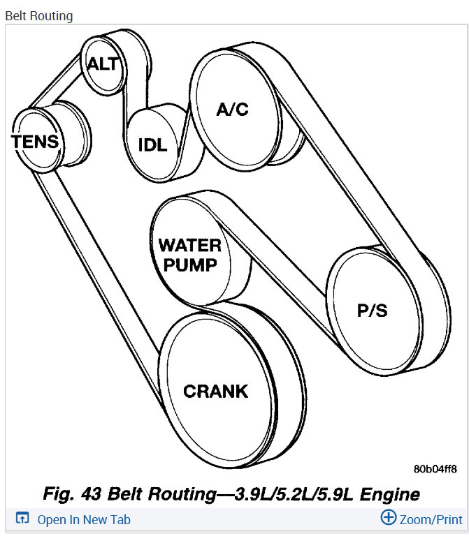

Serpentine belt riding toward the motor?
1998 DODGE DURANGO
370,000 MILES • 5.2L • V8 • 4WD • AUTOMATIC
WENDY TILLEY
I changed the water pump now my belt is riding toward the motor on the A/C pulley. Could the idler pulley be bad?

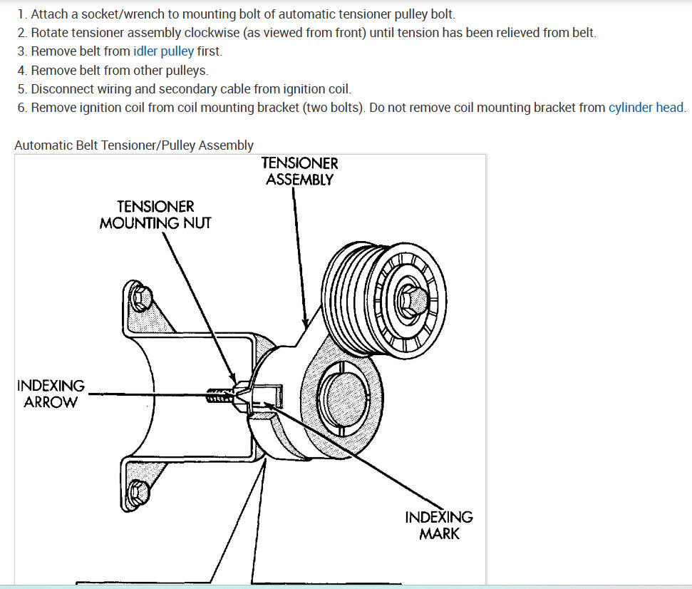

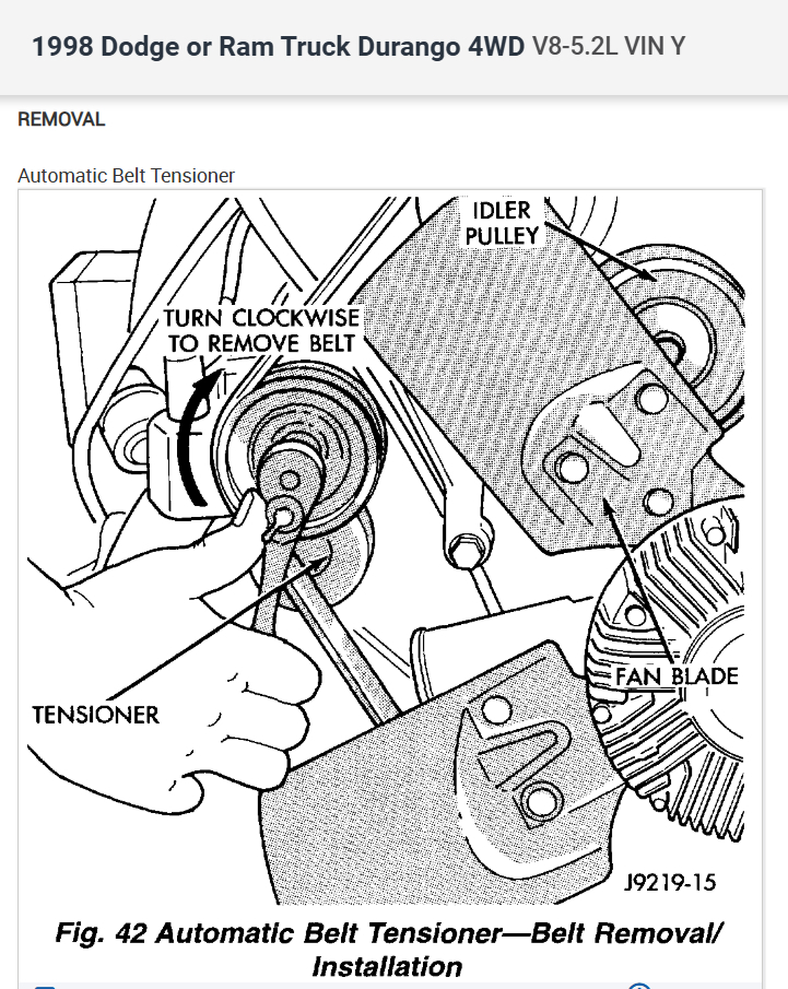

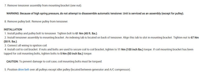

Yep, this is what happens when the belt tensioner needs to be replaced. Here is how the job is done. Check out the images (below). Please let us know what happens.

So replacing the idler pulley should be a fix?
Feb 2, 2025 at 4:06 AM
  • 55,433 POSTS
It should but I would check to make sure the belt is installed correctly, (see if all of the ribs are on correctly).
