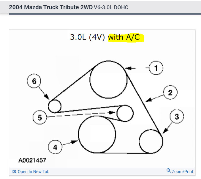

I need a diagram for the serpentine belt routing.
Sep 15, 2023 at 6:17 AM
Experienced Mechanic
110,248 POSTS

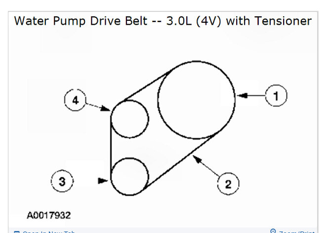

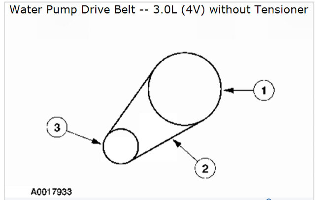

From what I am seeing, there is a serpentine belt (pic 1 below) and a water pump belt that can have a tensioner or not. I attached all the pics I have. Take a look at them and let me know if they help.
