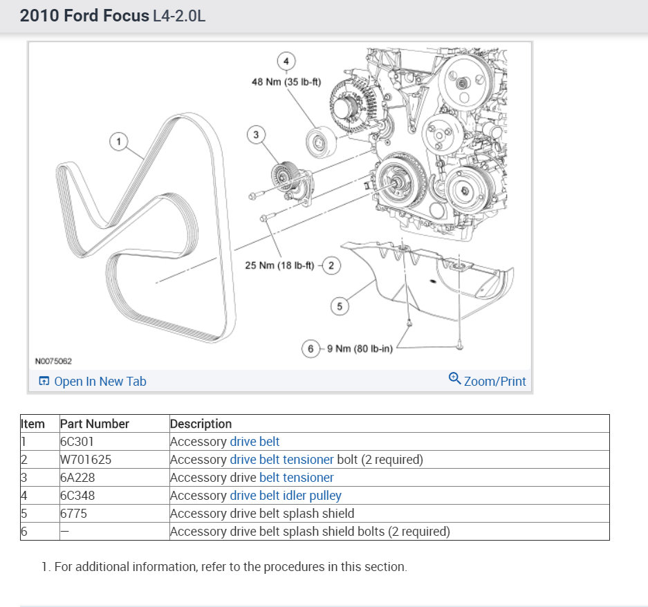

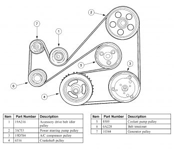

Serpentine belt busted on my 2010 Ford Focus. It had melted onto the pulley, so I replaced both tensioner and idler pulleys, along with serpentine belt. Now when I start the car, it dies within 30 seconds, and starts smoking. Check engine light is on, which it wasn't before the belt broke. So is this just something I may have done wrong with either the pulleys or putting the belt on? I have been trying to get this fixed and drivable for 2 weeks and I'm so extremely frustrated. Help!
Dec 26, 2015 at 11:03 AM
CARADIODOC
  • 34,413 POSTS
More than likely something is locked up. The generator is the best suspect. Loosen the belt again, then spin each pulley by hand to see which one is stuck.
What is smoking, the belt or something with the engine? Here is the serpentine belt diagram below. Check out the diagrams (Below). Please let us know what happens.

If I understand correctly, the belt was melted before you replaced parts. That tells me it's not that you did something wrong. It's that you didn't go far enough to find the cause of the problem. You only repaired the result.

I think our replies crossed in the mail. You don't have to remove the belt again. Just loosen it enough so you can spin each pulley by hand. Or you can watch for which one is not turning while a helper cranks the engine.

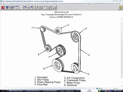

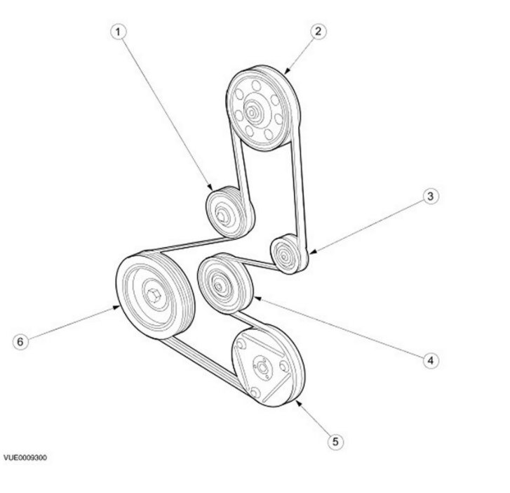

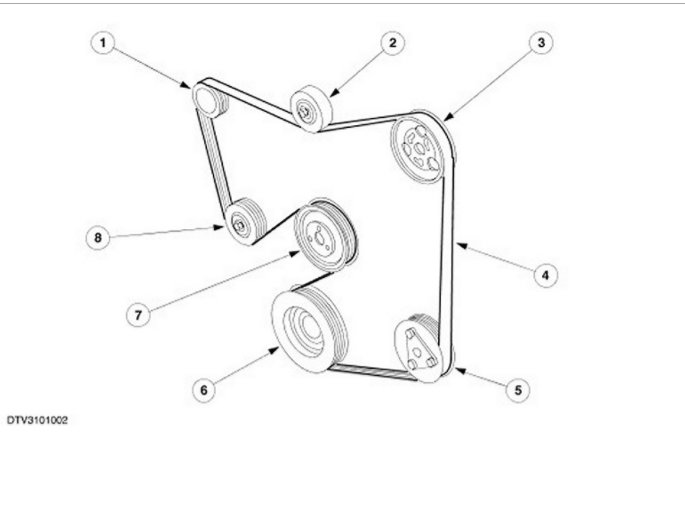

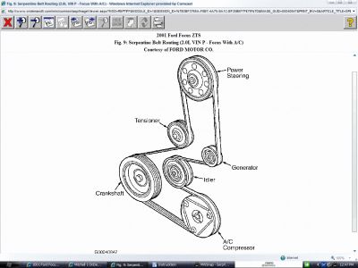

can anyone give me a drive belt diagram for a 1.8 focus zetec with air con
Jun 20, 2020 at 6:09 AM (Merged)
MERLIN2021
  • 17,250 POSTS
there are 6 possibilities, here are the 3 engines with A/C...
https://images.2carpros.com/forum/automotive_pictures/62217_Belt_1.jpg
https://images.2carpros.com/forum/automotive_pictures/62217_Belt2_1.jpg
https://images.2carpros.com/forum/automotive_pictures/62217_Belt3_1.jpg

HIPIS
Concerns about the timing belt is the way I have a question. Can someone explain to me how to replace the in the Ford Focus? Maybe one of you has a description of the exchange or litter may be a link.
MERLIN2021
  • 17,250 POSTS
I recommend you buy a shop manual for it at a parts store, you will need the info to avoid damaging internal engine parts, and as a reference as you do the work.

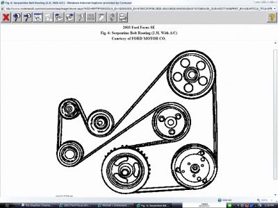

JANET
  • 5 POSTS

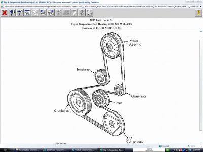

belt diagram for 2003 Ford Focus wagon with Air conditioning
DRCRANKNWRENCH
  • 3,380 POSTS
There are a few possibilities.
I have attached one. Let me know if that is what you are looking for.
I will keep an eye on this post and give you another diagram if this is not it.
JANET
  • 5 POSTS
Sorry this is not the right one. It's a 2L. Spilt Port engine. Thie diagram is for a Zetec engine. It's not the right set up.
JANET
  • 5 POSTS
Not that one either
JANET
  • 5 POSTS
Not this one. It seems to be the same as last two...is this the only diagram there is ????

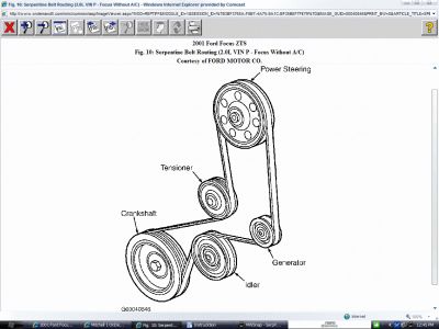

2001 Ford Focus 4 cyl Front Wheel Drive Automatic
I'm looking for a belt diagram for a 01 focus zts zetec DOHC can't find one anywhere. someone please help!
MERLIN2021
  • 17,250 POSTS
https://images.2carpros.com/forum/automotive_pictures/62217_SerpVINP_1.jpg
https://images.2carpros.com/forum/automotive_pictures/62217_SerpVINPWAC_1.jpg
