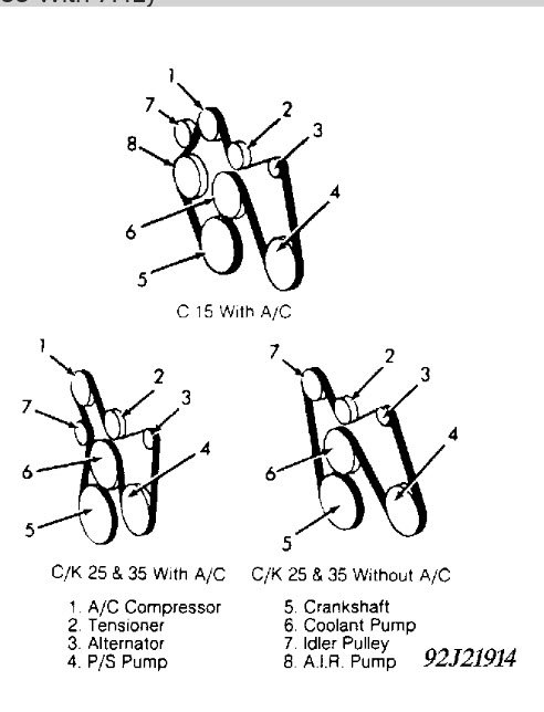

Need a diagram specific to that exact make and model got a 1992 belt because the body is a 1992 and it did not work because, as I learned through this, the engine is a 1991.
It is actually a Chevrolet Tioga Arrow by Fleetwood.

So you have a 1991 Chevrolet 7.4L engine ?
May 27, 2017 at 1:12 AM
SUSANBAINSHEDDAN
it's a 454
Jun 7, 2017 at 7:24 AM
HMAC300
  • 48,601 POSTS

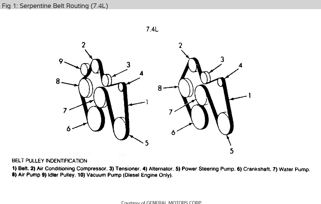

try these one should work first pic from 91
