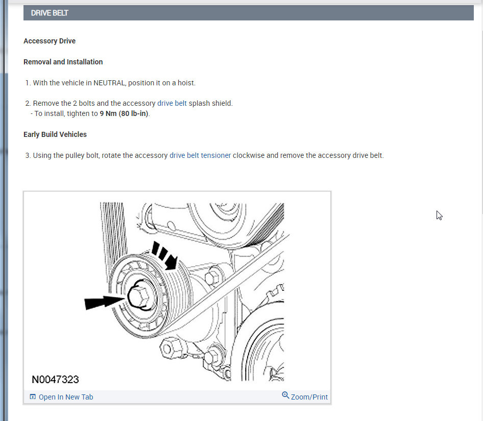

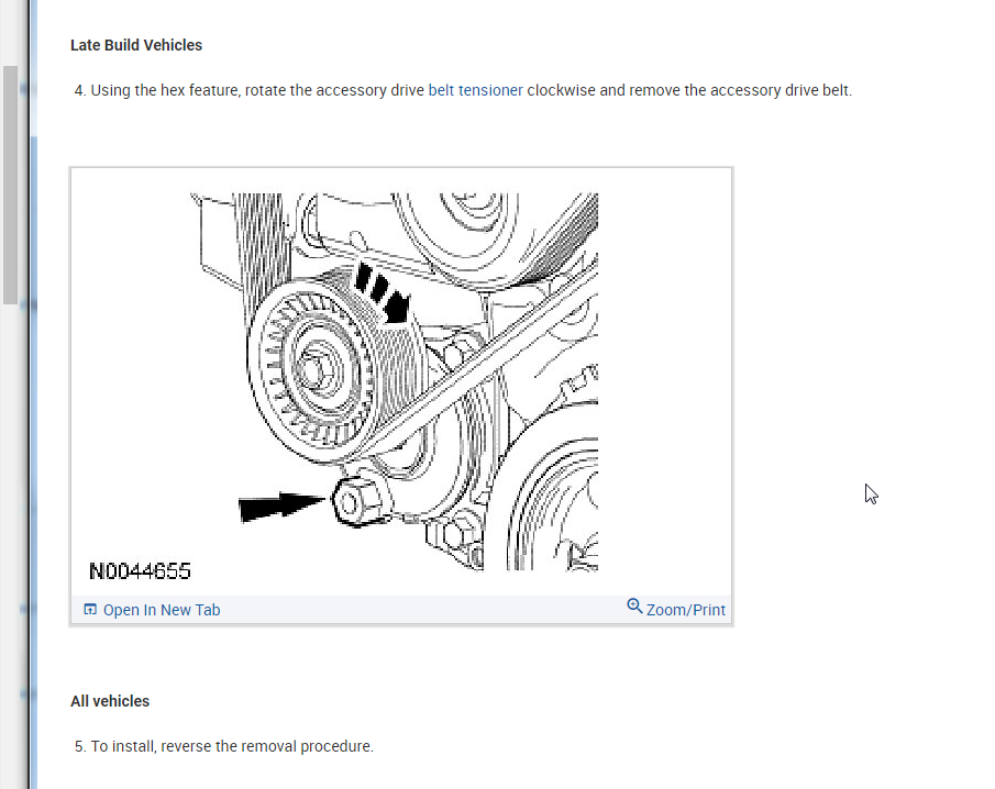

Then we need to check and make sure the tensioner is operating properly and putting the proper tension on the belt. Here is a guide that talks about this:
https://www.2carpros.com/articles/serpentine-belt-tensioner-replacement

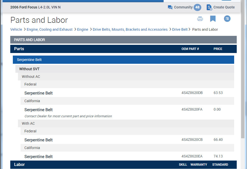

Lastly, I attached the different part numbers depending on how the vehicle is equipped. I would suggest calling the dealer and having them run the VIN and pulling the exact part number. Clearly it will be one of these but we need to know if it has California emissions or not.
