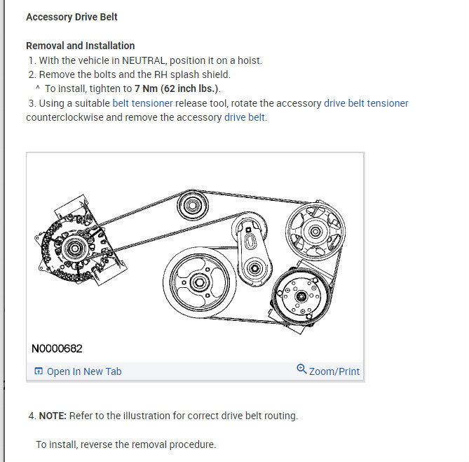

I need a diagram.
Oct 10, 2021 at 12:36 AM
Here is a guide that will help replacing the drive belts. It does not include your diagram but may be useful for you or others in the future.
I am attaching the diagram below and process from the manual that will help with this.
Please let us know if you need other info. Thanks
