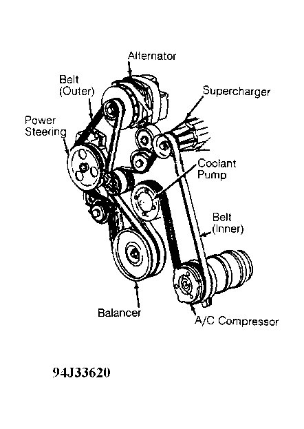

How to install the belt?
Feb 13, 2017 at 10:25 AM
STEVE W.
  • 15,404 POSTS
Rotate the spring loaded belt tensioner next to the supercharger pulley away from the belt. Remove the belt. Install new belt on lower pulleys. Move tensioner again to install the belt onto the supercharger pulley, release the tensioner.
