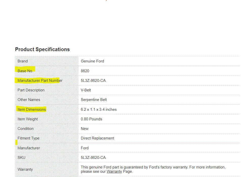

Thanks for the info. The alternator was replaced as well but it's been a few years. Is there a chance that one of the pulleys that were replaced could actually be the wrong size? If it was would it still fit? If so, maybe that's why each new belt keeps getting stretched out after a few weeks because when the belt is new there is no noise at all.
Nov 22, 2021 at 9:35 PM
  • 110,251 POSTS
Absolutely if parts were replaced that came with a new pulley, it could be different. Remember, the automatic tensioner can only go so far before it bottoms out. After that, it can't tighten anymore. Also, the belt can be too long. I attached the original part number below and specifications for the one it should have. See if you can find your belt's part number and let's cross-reference it.

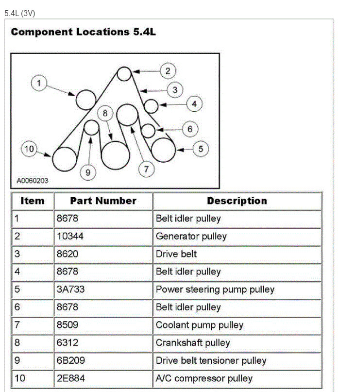

Also, confirm it is routed properly. See pic two for belt routing.
Let me know what I can do to help.
