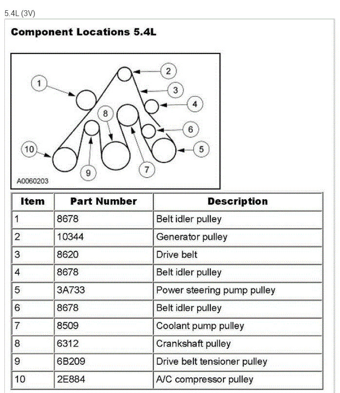

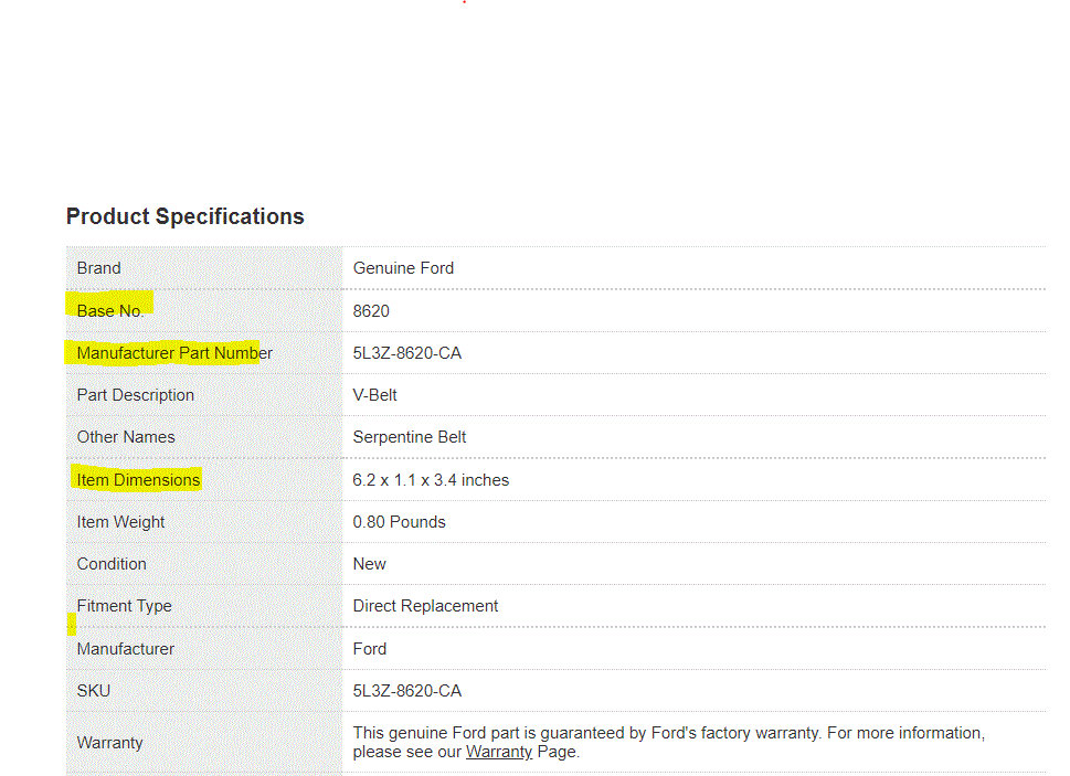

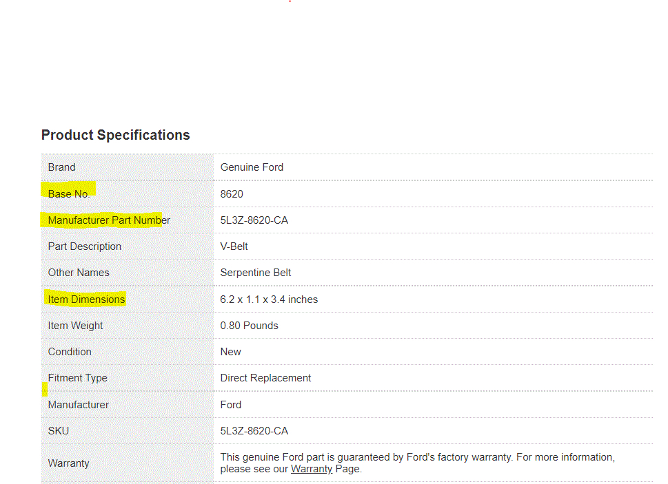

Absolutely if parts were replaced that came with a new pulley, it could be different. Remember, the automatic tensioner can only go so far before it bottoms out. After that, it can't tighten anymore. Also, the belt can be too long. I attached the original part number below and specifications for the one it should have. See if you can find your belt's part number and let's cross-reference it.

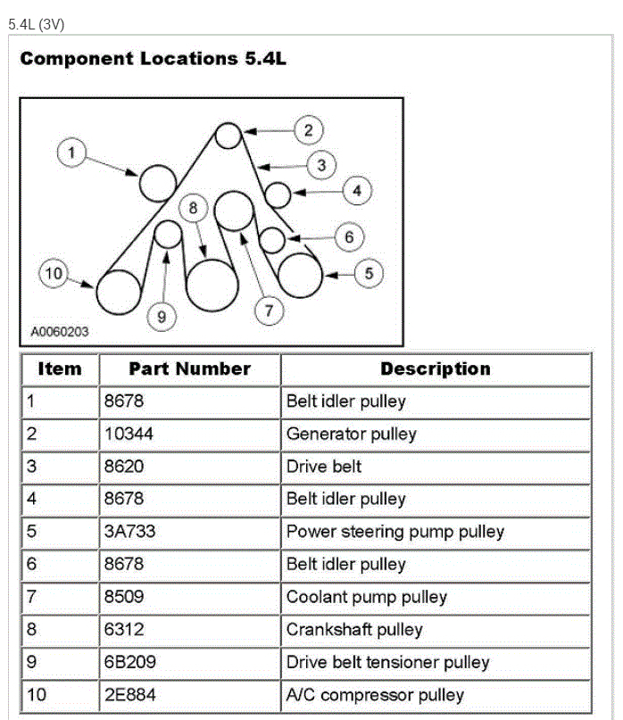

Also, confirm it is routed properly. See pic two for belt routing.
Let me know what I can do to help.
See pic below.
