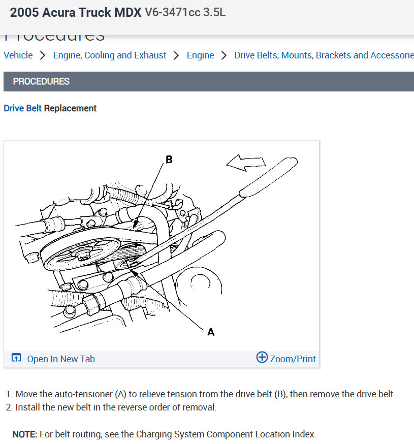

I want to know the length of the replacement serpentine belt i should get. I can remove and replace it however I would like to know the length and type.

For a 2005 Acura MDX with a 3.5L V6 engine, the replacement serpentine belt specifications are as follows:
Length: Approximately 83.7 inches (2126 mm)
Part Number: Common part numbers vary by manufacturer:
Gates: K060827
Dayco: 5060827
ACDelco: 6K827
Bando: 6PK2105

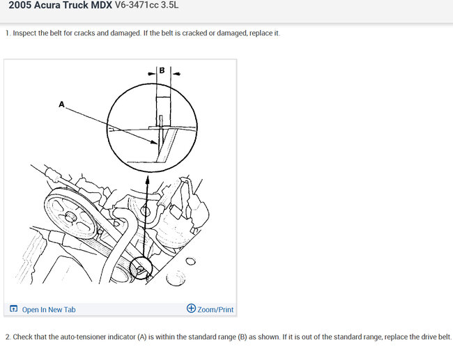

Here is how to replace the serpentine belt in case you need it. Check out the images (below). Let us know if you need anything else.
