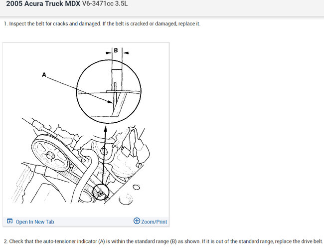

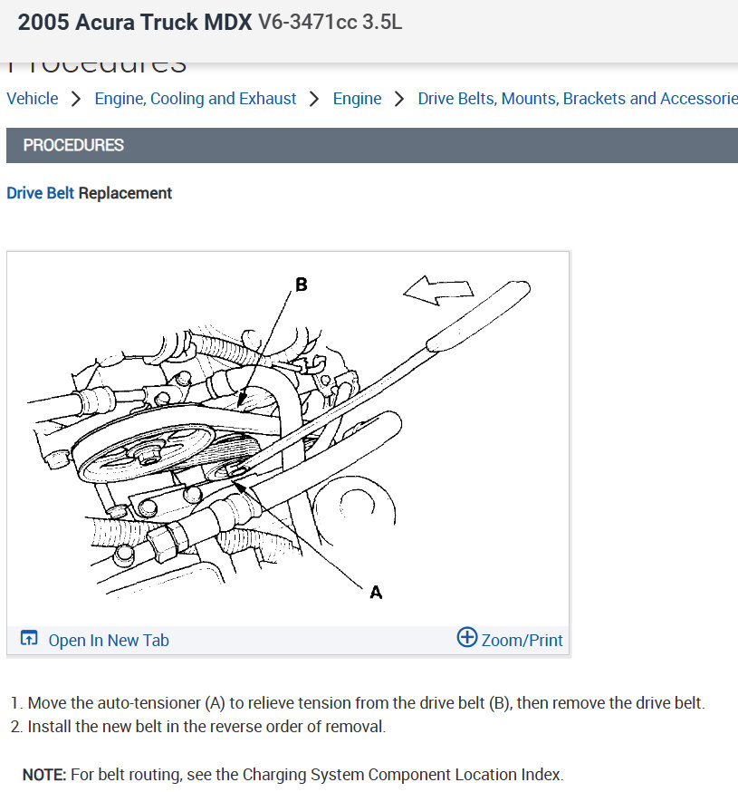

I want to know the length of the replacement serpentine belt i should get. I can remove and replace it however I would like to know the length and type.

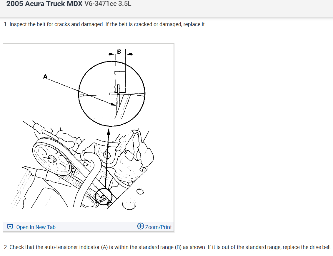

Here is how to replace the serpentine belt in case you need it. Check out the images (below). Let us know if you need anything else.
