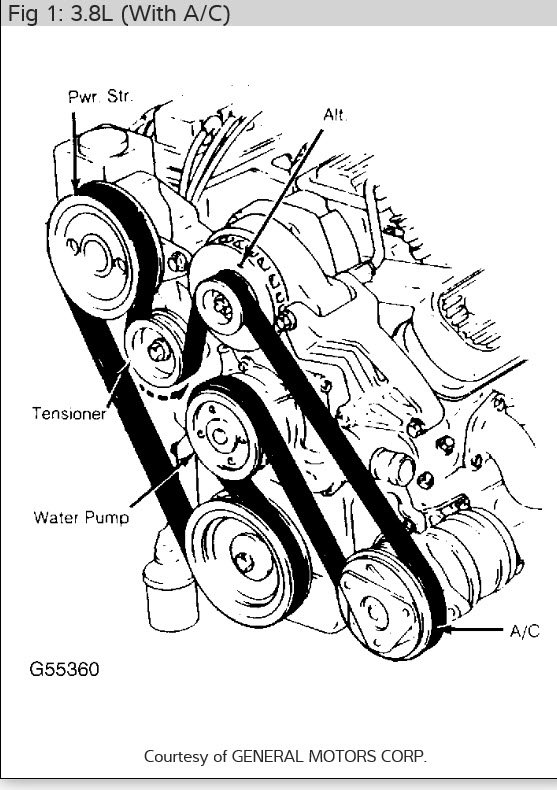

The serpentine belt slipped off and I need diagram to put back on. The specs are listed above.

I am not sure about the liter It is a V6 front wheel drive.

If belt came off check for a worn tensioner and component out of alignment like one of pulleys. Tensioner should be replaced when belt is see picture.
