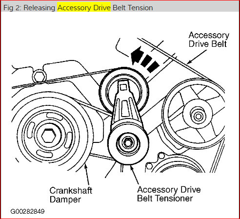

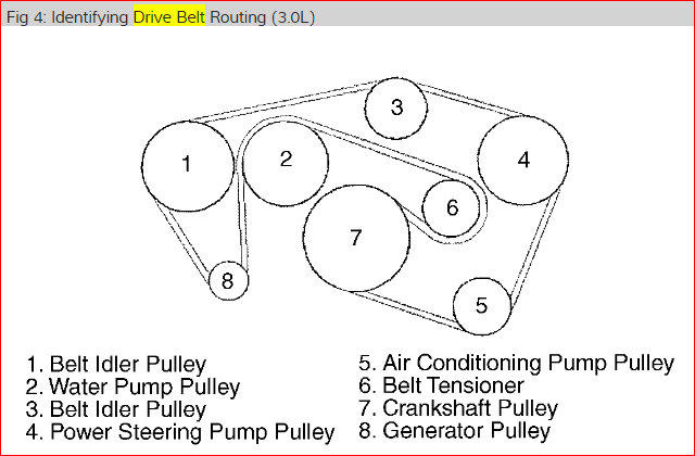

How do you change the fan belt and loosen tension pulley?
Sep 7, 2018 at 1:15 PM
DANNY L
  • 5,648 POSTS
Hello, I am Danny.
I have attached a few pictures showing the belt routing and the tension-er location. I have also attached a tutorial showing what is involved in the replacement. Using a long handled 3/8 drive ratchet or a Serpentine Belt tool move tension-er counter clockwise to remove tension to remove the Belt. Hope this helps and thanks for using 2CarPros.
