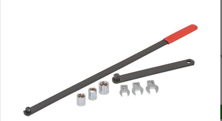

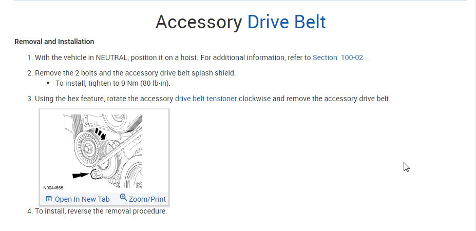

I would like to know the tools to replace a serpentine belt tool. I’ve been told I needed a 10 mm socket wrench with an extension bar.
Nov 17, 2020 at 10:33 PM
I am attaching the process to replacing the belt. You could use a socket and extension bar or the tool pictured that was made for this. It has a variety of sockets that will fit most all vehicles including yours. Just search serpentine belt tool and it will pull it up.
Let me know if you have questions.
