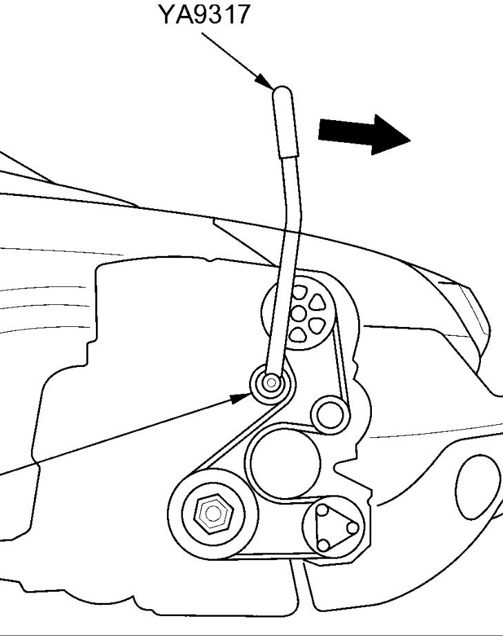

I need a serpentine belt diagram.

Here you go. Belt diagram for the 2.4. Normally done through the wheel well. Hang the belt on top then around the lower pulleys and then move the tensioner so the belt can slide in place.
Image (Click to enlarge)
