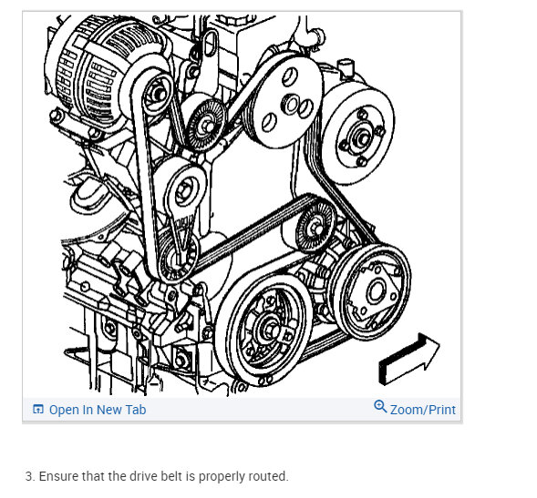

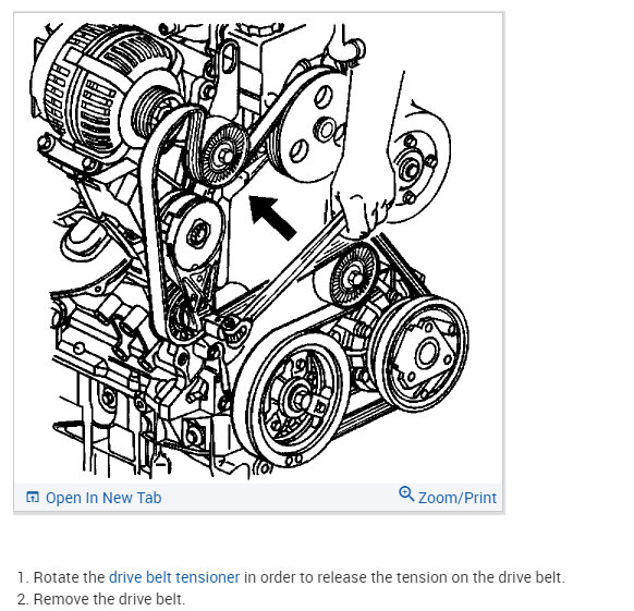

Serpentine belt diagram needed?
2001 PONTIAC MONTANA
200,000 MILES
BECKY WILKEY
Diagram on serpentine belt.
Aug 9, 2023 at 9:52 AM
  • 110,240 POSTS

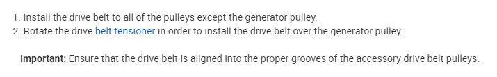

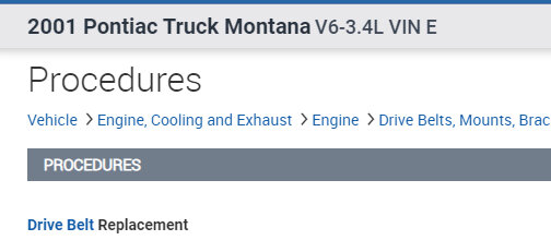

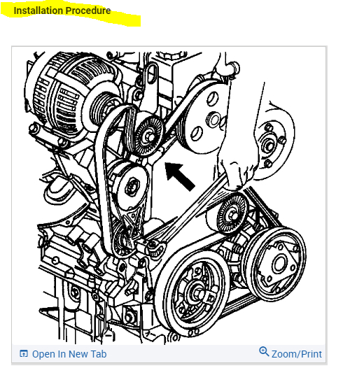

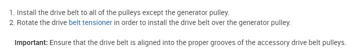

I attached the directions for removing and installing the serpentine belt. See pics below
