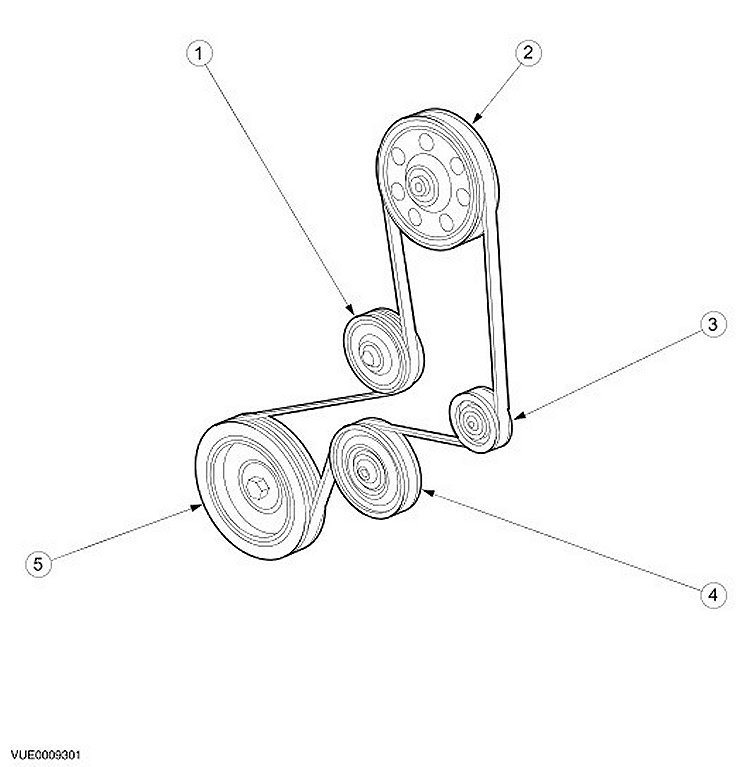

Need to know how to replace the belt.

There are two different 2.0L engine possibilities. One is a single overhead cam the other is a dual overhead cam. I will provide directions for both.
______________________________-
Single Overhead Cam
2000 Ford Focus L4-2.0L SOHC VIN P
2.0L SPI
Vehicle Engine, Cooling and Exhaust Engine Drive Belts, Mounts, Brackets and Accessories Drive Belt Service and Repair Procedures Drive Belt 2.0L SPI
2.0L SPI
Accessory Drive Belt - 2.0L SPI
Removal

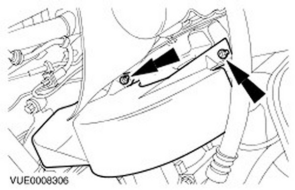

1. Raise and support the vehicle.
2. Remove the accessory drive belt splash shield.
see pic 1
3. Lower the vehicle.

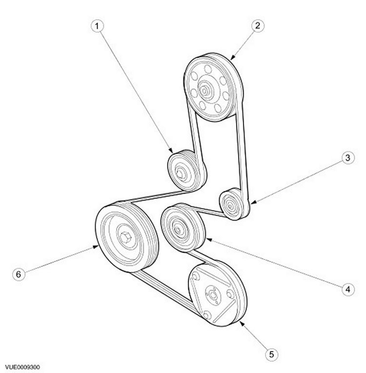

4. Remove the accessory drive belt.
- Using a 3/8 inch square drive breaker bar in the hole provided, rotate the tensioner clockwise.
pic 2
Installation

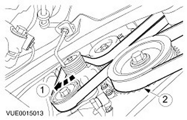

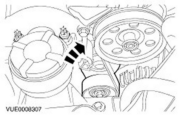

1. To install, reverse the removal procedure.
Note: Pic 3 shows belt routing with AC and pic 4 is without AC.

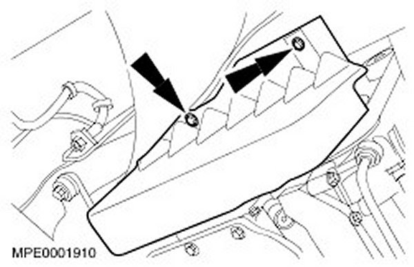

2. Remove the splash shield.
pic 5
3. Remove the accessory drive belt.
- Rotate the accessory drive belt tensioner clockwise.
- Remove the accessory drive belt.
pic 6

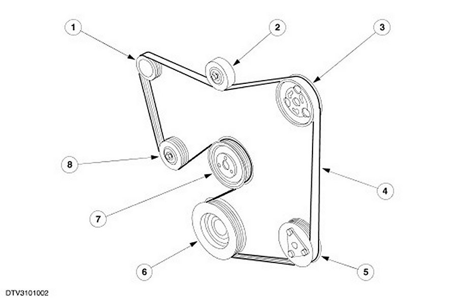

Installation
Pic 7 shows belt routing for the Z-tec
