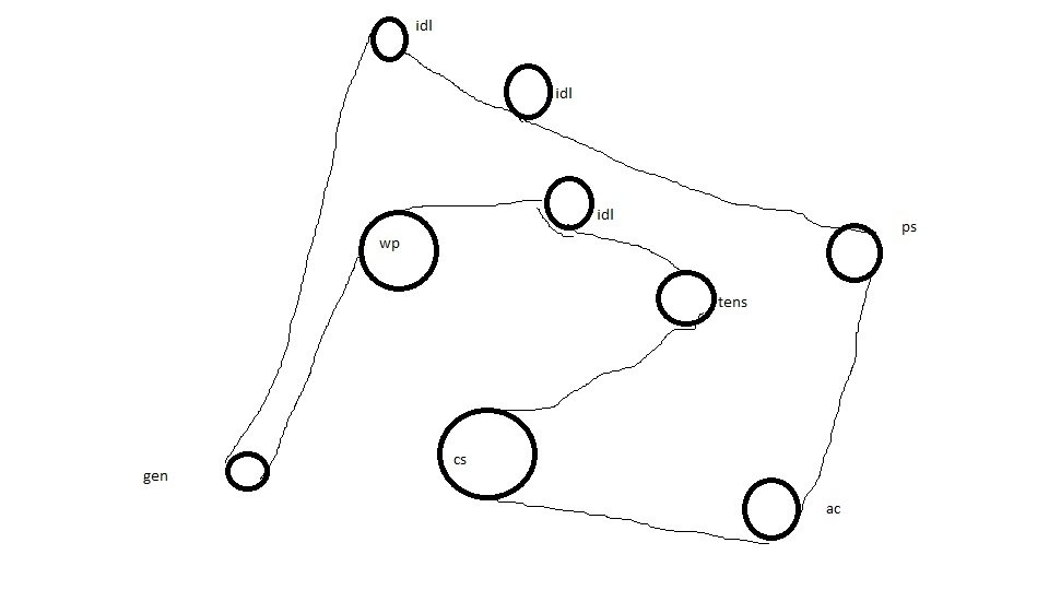

I am trying to put the belt on, but i cannot find the right diagram.

Is this a 6.3L engine? Sometimes there is a belt routing decal, under the hood?
My free-hand is not very good, I labeled the pulleys. I do not know if this is what you have?
I found the belt routing in a tune-up manual, 2008 Mercedes 6.3L engine.
