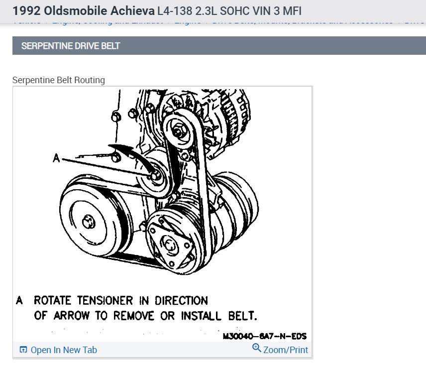

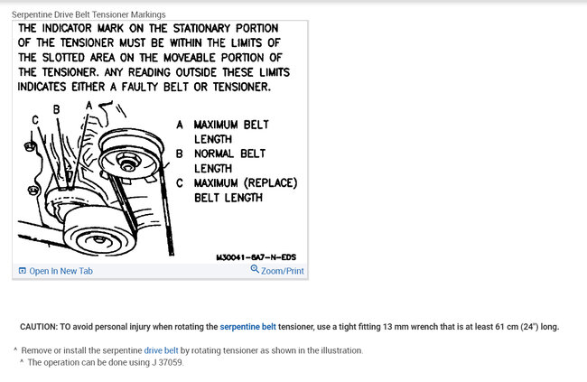

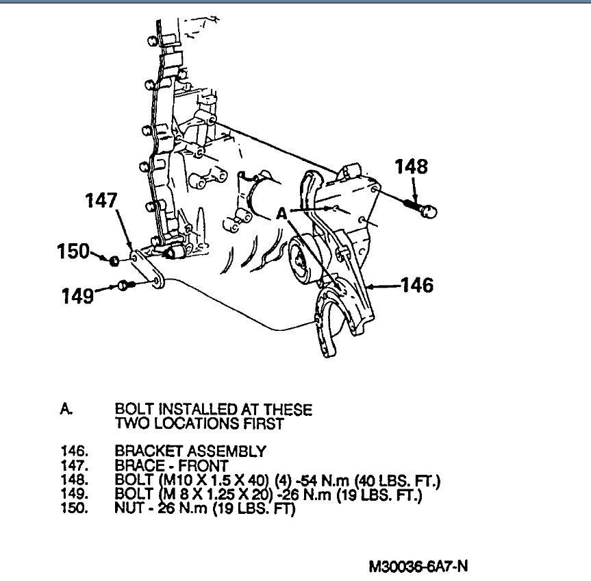

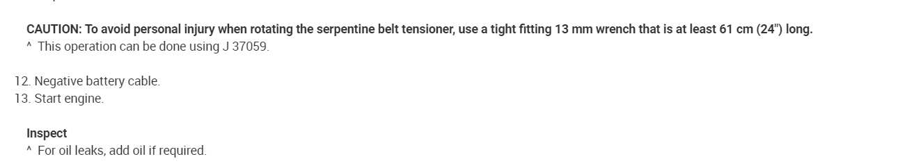

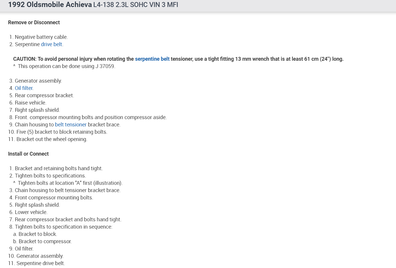

Car was running hot notice tensioner is bad, needs to be replaced, needing instructions.
Jun 14, 2023 at 4:36 AM
  • 54,837 POSTS
Sure, these are instructions on how to replace the serpentine belt and the belt tensioner. I have also included this guide to help walk you through the steps:
https://www.2carpros.com/articles/serpentine-belt-tensioner-replacement
Check out the images (below). Please let us know if you need anything else to get the problem fixed.
