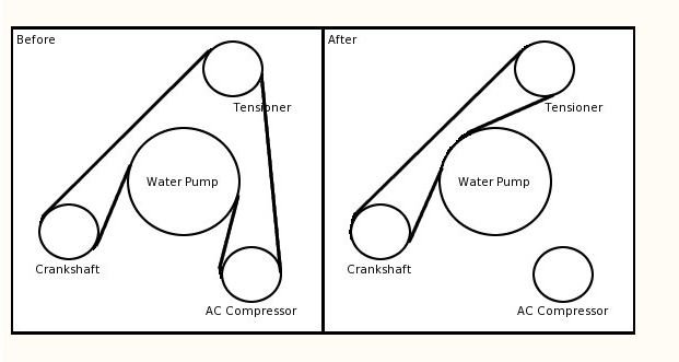

I need to replace the serpentine belt and will be bypassing the A/C compressor. I need to know what length the serpentine belt should be and also need a diagram.
Jan 12, 2021 at 7:25 AM
Good morning,
I attached the diagram for you of the belt system.
In order to do this job, you need a 398K4 belt. There will not be much contact with the water pump and that concerns me.

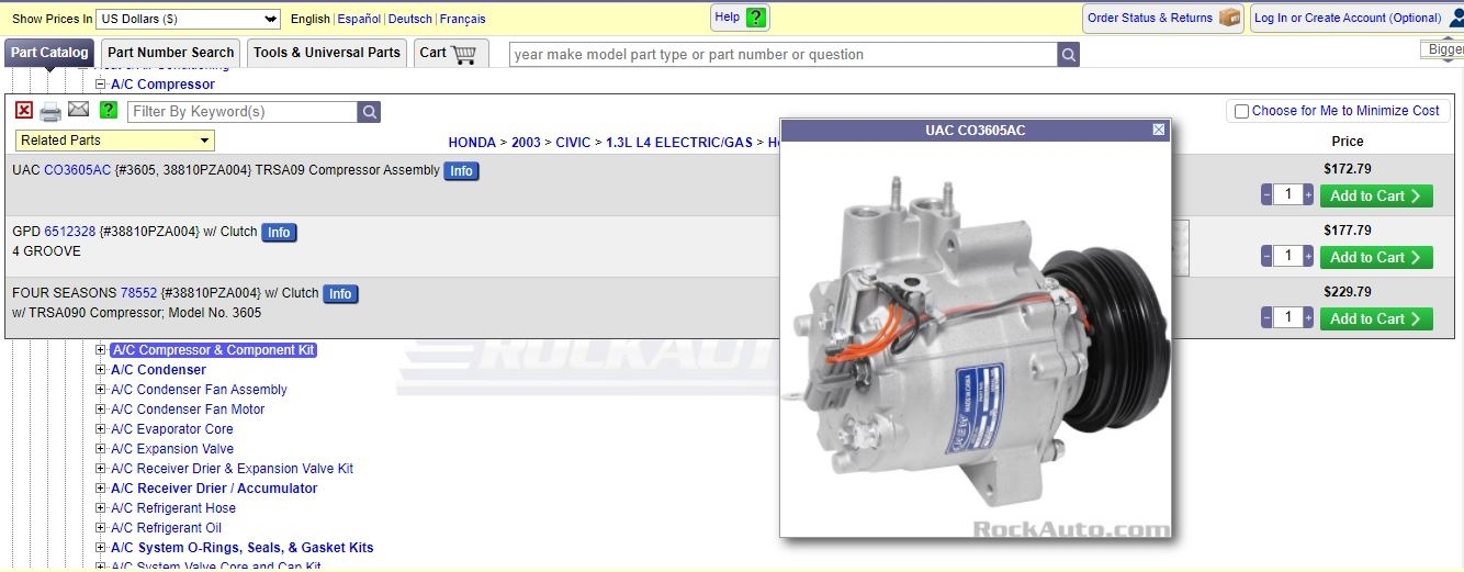

The A/C compressor went bad and i can't afford a new one and also can't afford to be without a car. is there another way?
Jan 12, 2021 at 8:18 AM
Not many options. The compressor is the only thing run by the belt beside the water pump.
https://www.2carpros.com/articles/replace-air-conditioner-compressor
I attached a compressor from rock auto. It is $172.00.
