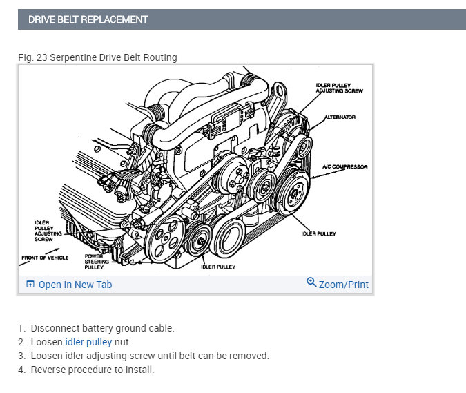

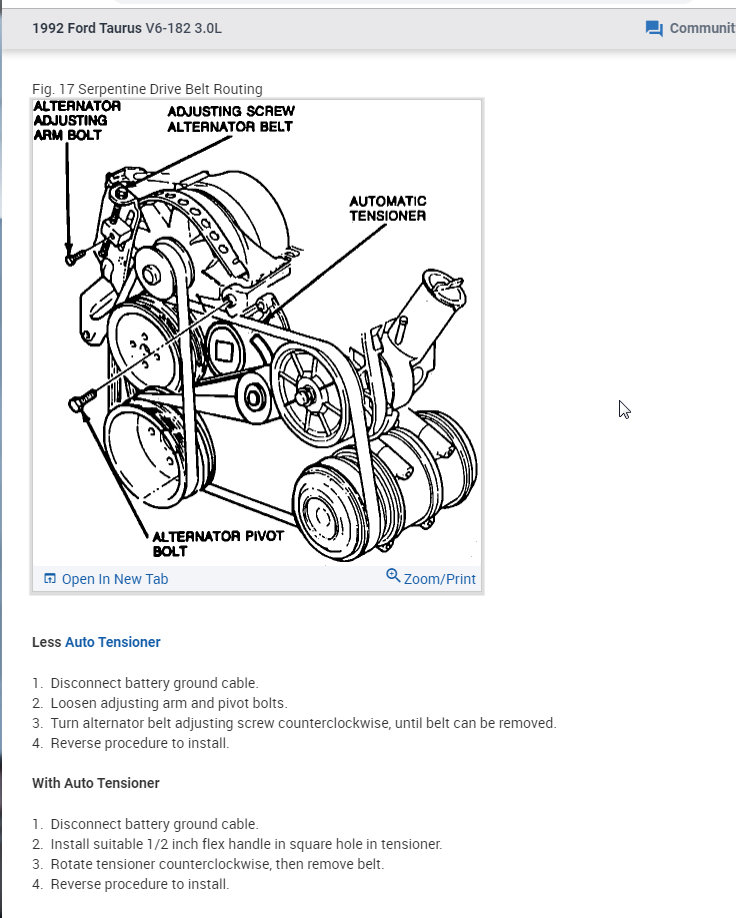

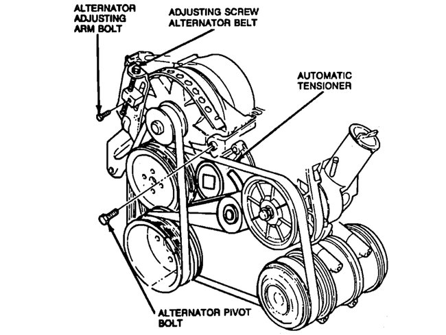

In the diagrams down below I have included the serpentine drive belt instructions for it's removal and installation for your vehicle from the vehicle manufacturer. Please go through this guide and report back on how everything turns out.
Thanks,
Alex
