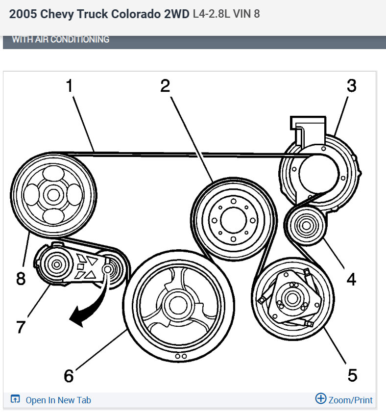

Forgot how to put the fan belt on. other diagrams show water pump pulley, mine has not.

Sure, here is the serpentine belt routing diagram, please check out the diagrams below and let me know if this is the correct engine size. Check out the images (below). Let us know if you need anything else.

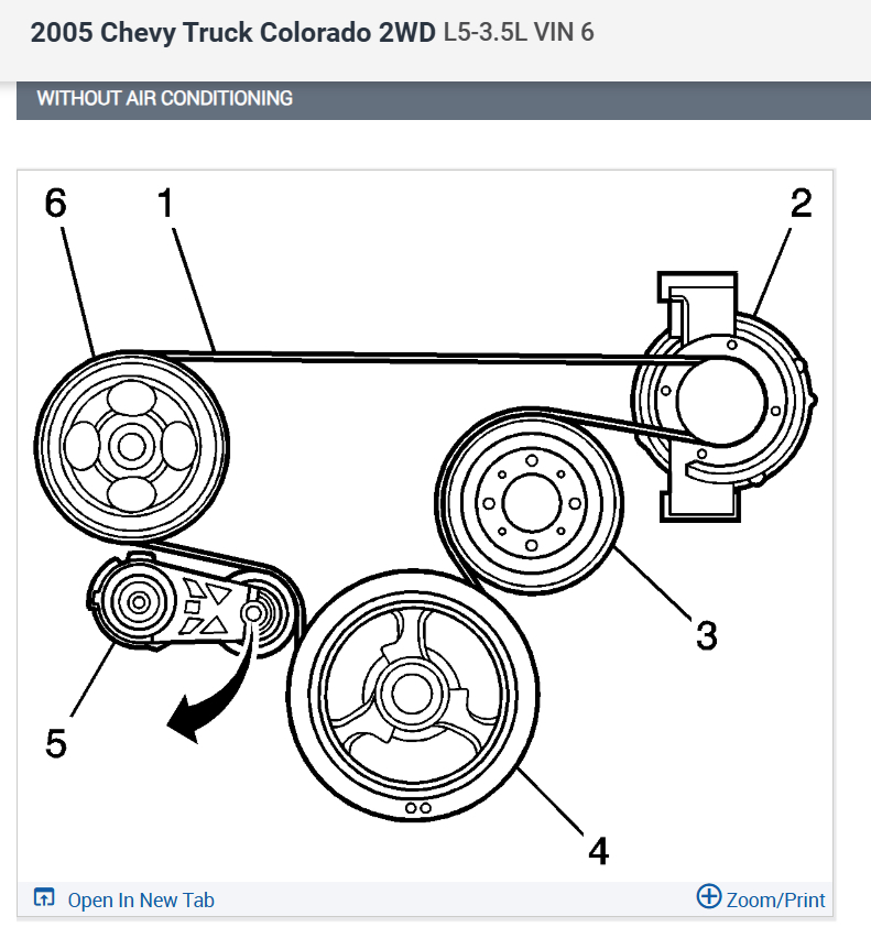

Need aus rodeo 6ve1 3.5.

It looks like it is the same routing, here is the from both AC and non-AC engines. Check out the images (below).
