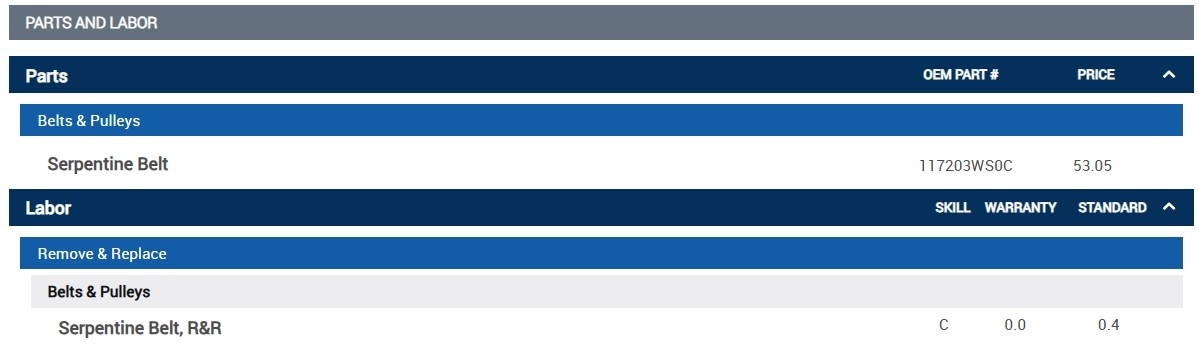

I have 5 pulleys I need the part number for the serpentine belt.
Nov 22, 2024 at 12:39 AM
AL514
Experienced Mechanic
5,683 POSTS

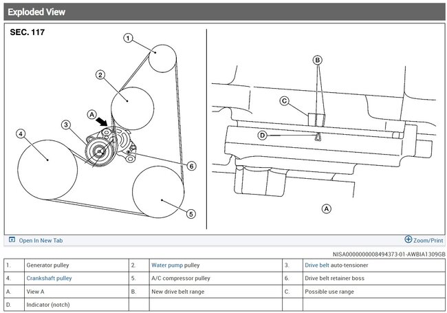

Hello, you're including the tensioner pulley in at 5 I assume? We have the belt number and diagram right here, I'll post it for you.
Nov 22, 2024 at 12:43 AM
AL514
5,683 POSTS
The OEM part number is in the first diagram.
