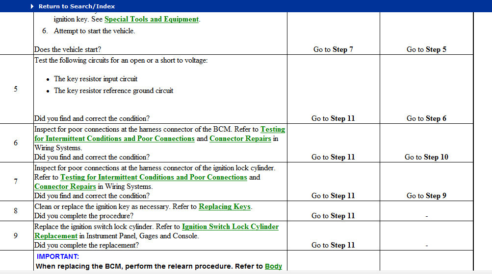

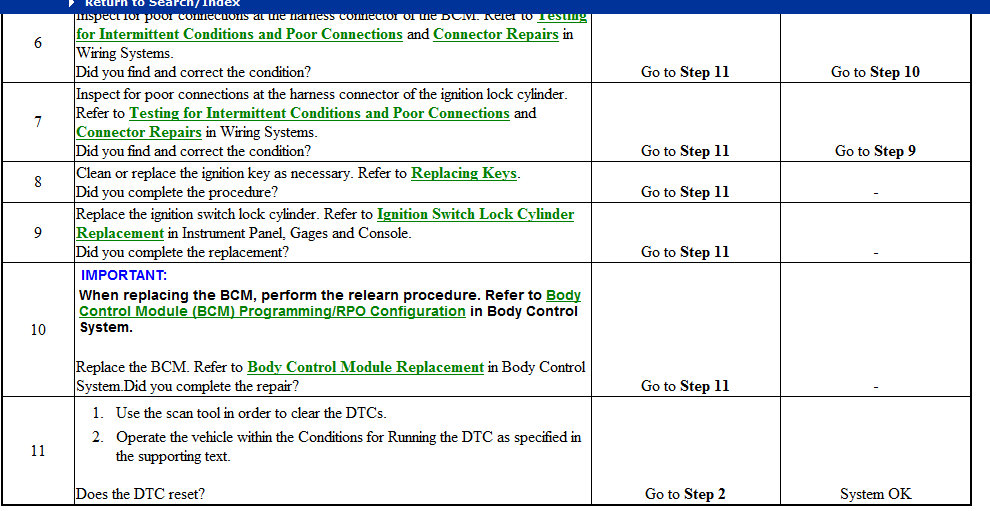

Security light stays on solid code b2723. Car does not start. turn key one three to four minutes car starts and will continue to start unless I clear the code. once I clear the code car does not start again until I leave key in the on position for three to four minutes.
Apr 4, 2019 at 2:40 AM
SEVAG P
  • 405 POSTS
hello thanks for using 2CarPros.

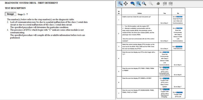

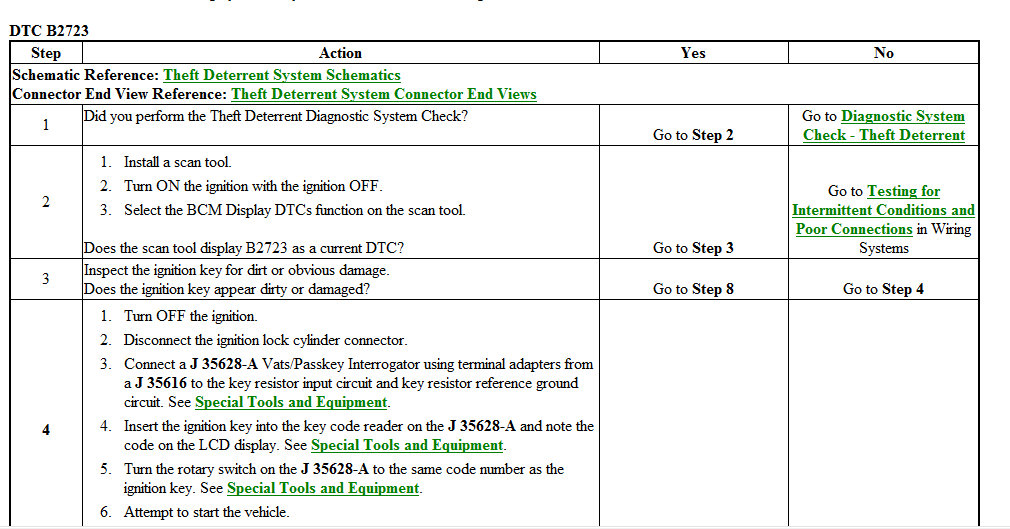

Fault code b2723 pass key detection circuit, check the fig 2,3,4 for complete trouble shooting for code b2723. fig 1 for diagnostic system check for theft deterrent.
let us know what happens.
