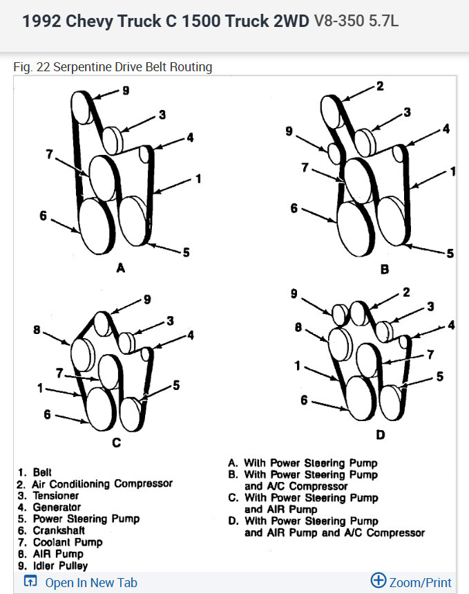

Need to know diagram for putting serpentine belt back on with A/C.

Yep, it can be confusing for sure, here are the serpentine belt diagrams as requested. Check out the images (below). Please let us know what happens.
