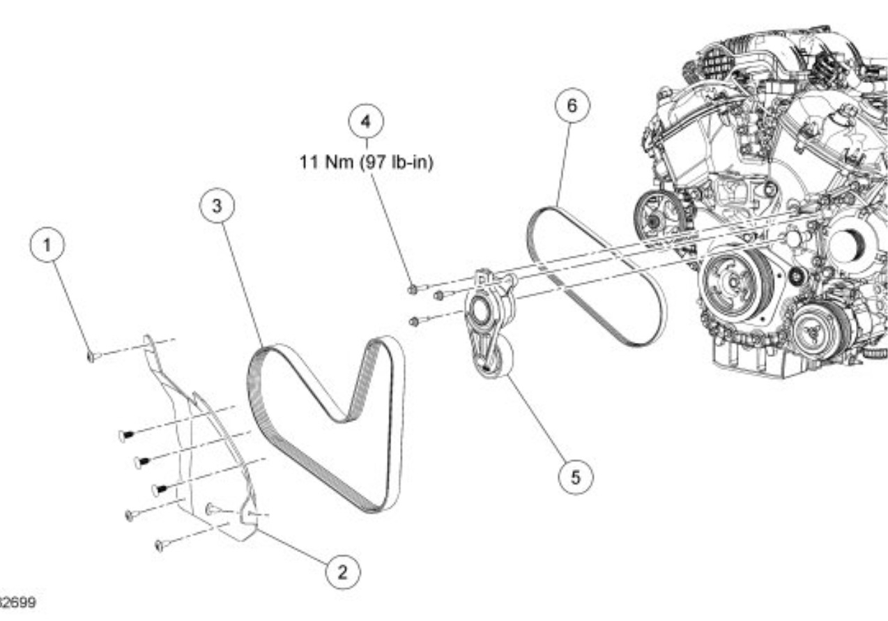

I need to know what my serpentine system pulleys are as one of the kids fell of the pulley why I was driving I'm unsure of what to do.

This is the routing for both belts on that engine. The inner power steering belt is a stretch type belt used if your car has hydraulic power steering and not electric. It uses a tool to remove and install it. The outer belt is a conventional belt that uses a spring type tensioner.
