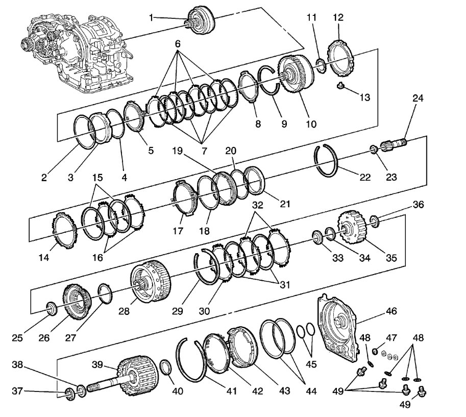

I have to replace my engines clutch and friction plates (Pressure plates) I first took out the first and reverse clutch pack then the second the planetary gear drives and there is a little 2.5 inch or so shaft that I cannot figure out where it goes again. And my camera cut out, so it didn't show where it goes. I am making a YouTube video, and I would like to know what it is called and where it goes. I am sure it came out of the 2nd, 3rd and 4th clutch pack area but when I look at everything it doesn't go anywhere, I could find. Please help. It has small splines on one end and the other has angled and curved splines.
do the washer bearings go out-wards or towards the other washer race.
And if you could, what are the torque specs for all Torque converter housing and internal clutch pack stabilizer (Not Sure on the Name)? Can't find it in my book.

Can you upload an image of what you are talking about and where it goes? Here is an exploded view and what the parts car called. Check the image below.
1 - Planetary Ring Gear
2 - O-Ring
3 - 1st and Reverse Brake Piston
4 - O-Ring
5 - 1st and Reverse Brake Piston Return Spring
6 - Plate
7 - Disc
8 - Flange
9 - Snap Ring
10 - Planetary Gear
11 - Thrust Washer
12 - No. 2 One-Way Clutch
13 - Anti-Rattle Clip
14 - Flange
15 - Disc
16 - Plate
17 - 2nd Brake Piston Return Spring
18 - O-Ring
19 - 2nd Brake Piston
20 - O-Ring
21 - 2nd Brake Clutch Cylinder
22 - Snap Ring
23 - Thrust Bearing Race
24 - Front Planetary Sun Gear
25 - Thrust Bearing Race
26 - One-Way Clutch Assembly
27 - Thrust Washer
28 - Rear Planetary Sun Gear
29 - Snap Ring
30 - Flange
31 - Disc
32 - Plate
33 - Thrust Bearing Race
34 - Thrust Needle Roller Bearing
35 - Forward Clutch Hub
36 - Thrust Bearing Race
37 - Thrust Needle Roller Bearing
38 - Thrust Bearing Race
39 - Forward and Reverse Clutch Assembly
40 - Thrust Needle Roller Bearing
41 - Snap Ring
42 - O/D Brake Return Spring
43 - O/D Brake Piston
44 - O-Ring
45 - Seal Ring
46 - Transaxle Rear Cover
47 - Governor Apply Gasket
48 - O-Ring
49 - Bolt Plug
