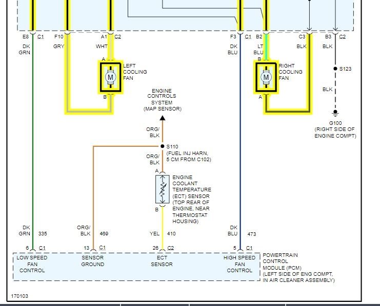

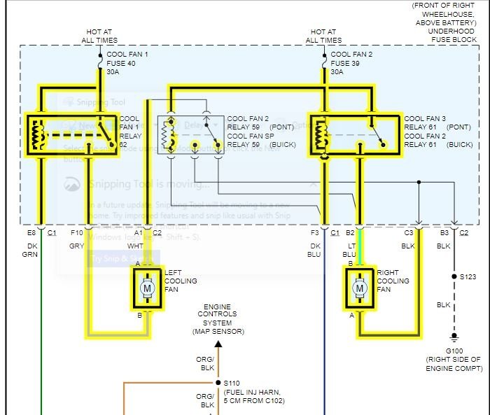

Mechanic turned sensors off on my car so the cooling fans would continuously run. I was in a wheelchair recovering from surgery for a broken leg and had to rely on someone else to drive me to appts and PT. It was her boy friend who took car to this particular shop. They had replaced the thermostat but fans wouldn’t kick in when they were supposed to, so mechanic talked to me and suggested he could turn sensors off to keep fans running. I just found out car won’t pass smog as long as “service engine soon” light is on which came on after sensors were turned off. I think vehicle check light has also come on a few times. I cannot take car back to same place and need to find someone who can turn them back on so I can get it smogged and overdue registration taken care of. I called a few places and they literally hung up on me when I asked if they could turn the sensors back on. A friend is checking it out for me now and said one of the fuses is missing and another one needs to be replaced. I can’t remember which one was missing off the top of my head right now but I am wondering if this can be turned back on manually so I can get it smogged and registration updated or if it has to be turned back on with the same computer app he used on his iPad? Can I reset and clear the “service engine soon” message to go ahead and smog it? I need to get transmission serviced, find oil leak and get a tune-up and check radiator. It is scary that the temperature gauge no longer worked once he turned sensors off and I would like to have it back on again now that I am able to drive again and maybe explore options about the cooling fans not coming on like they are supposed to. I see several others on here have had similar issues with theirs. If someone could please point me in the right direction, I would be so very thankful.

First, you cannot turn off the sensors for the cooling fan. That is why you got the response you did from the shop you called. That is not possible.
It sounds like he jumped a relay to run the fans all the time for you. I attached a wiring diagram of the fans for you to view. Tests will need to be done to find the reason for them not coming on.
I need the code that is set to prevent the emissions from passing. Can you post it here for me?
