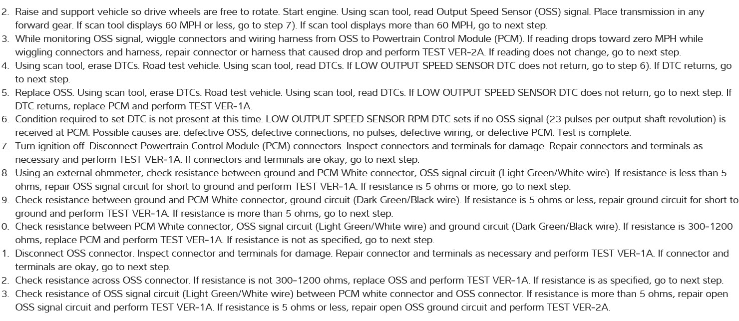

I changed the o2 Senors and it fixed the problem thanks I have another problem it is throwing code po 720 which is for the speed sensor I changed it and it didn't help at all what should I check next?

follow instruction on pic. you willnot be able to do anything that says to use a scan tool because it take a pro model to do that.
