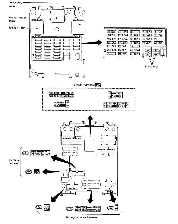

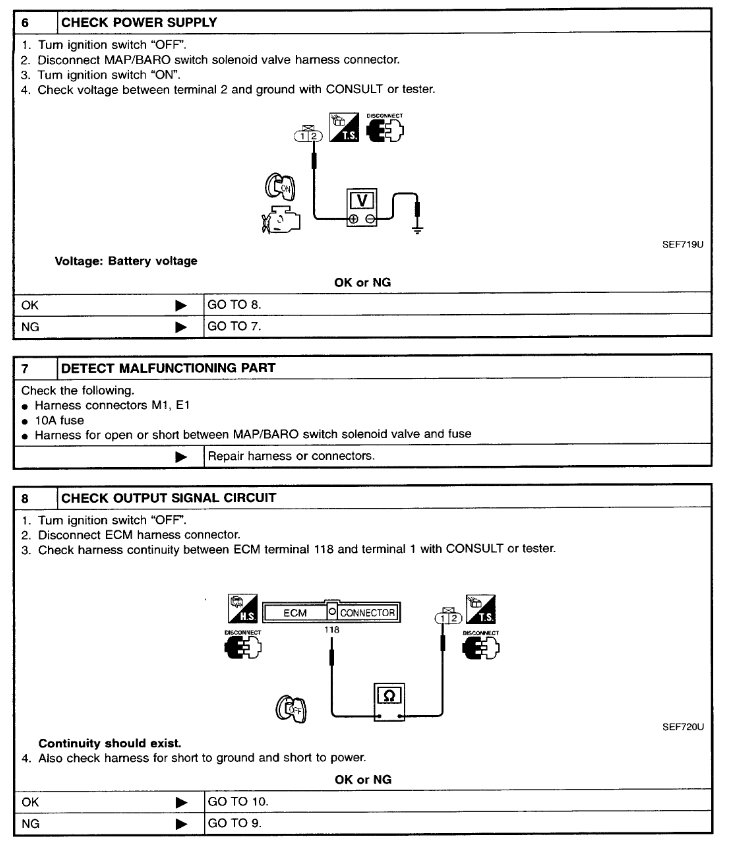

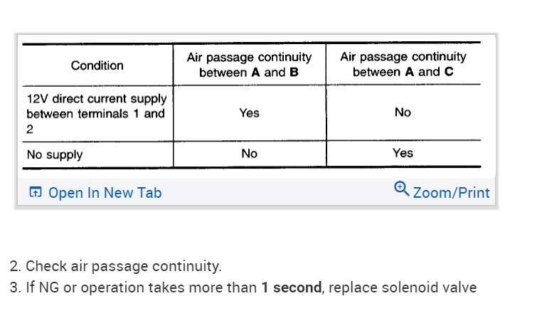

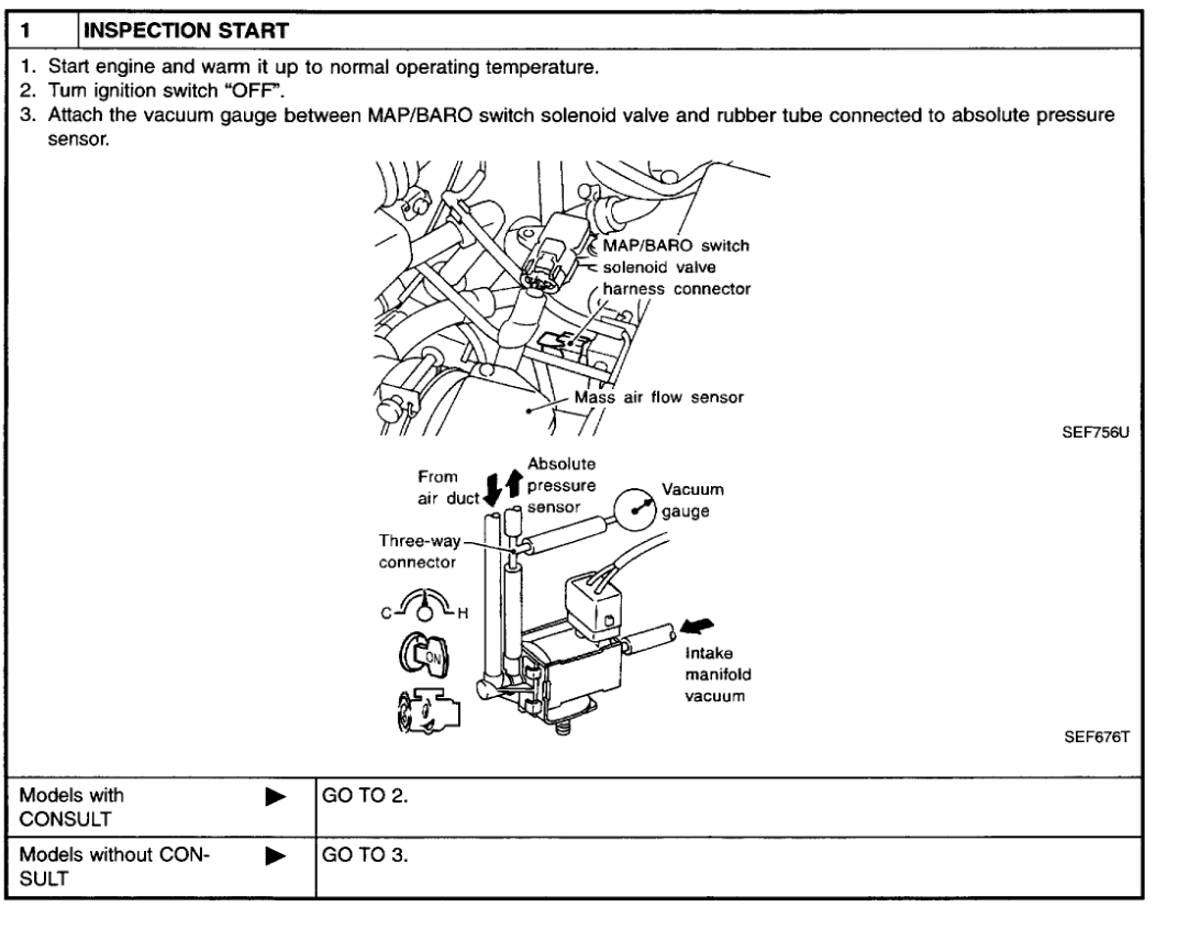

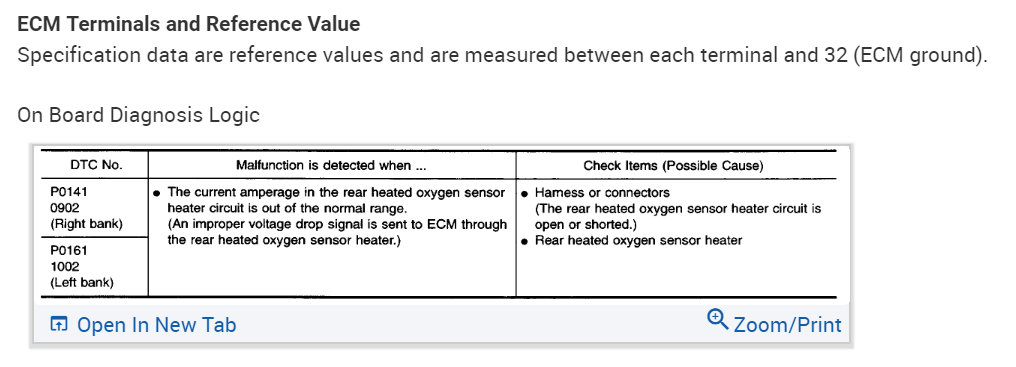

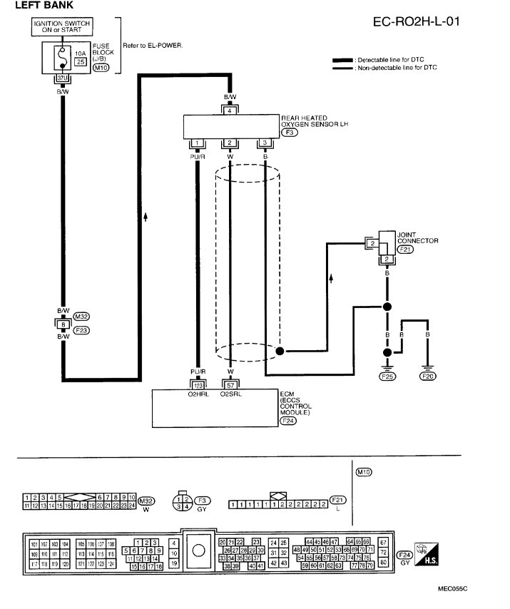

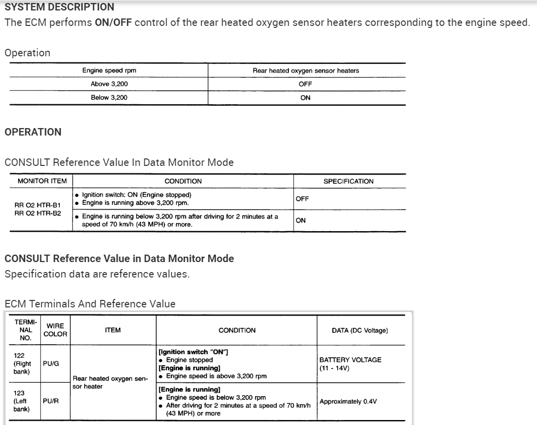

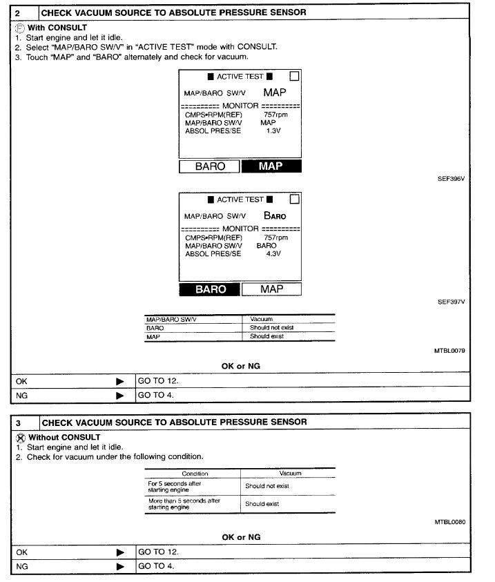

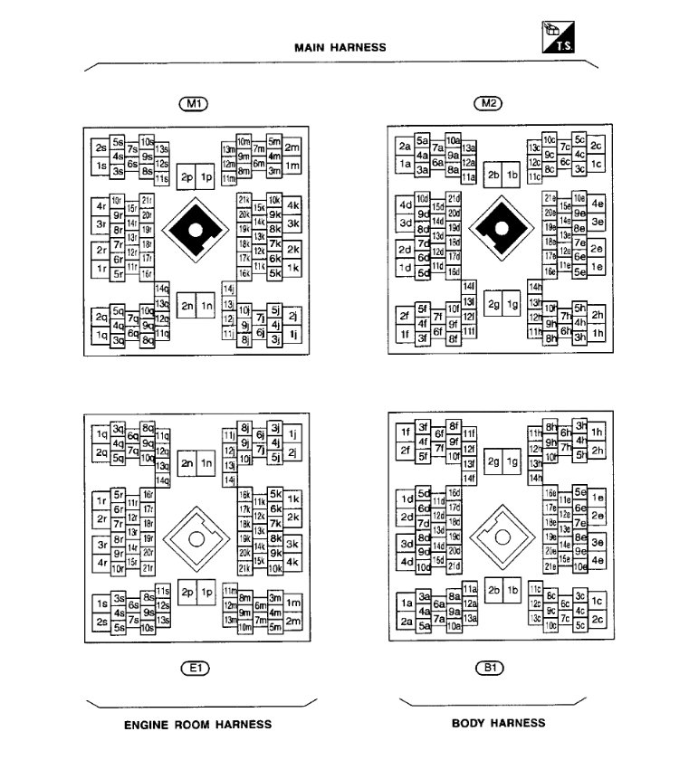

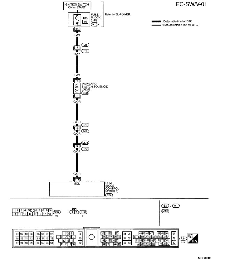

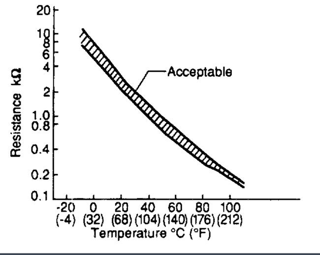

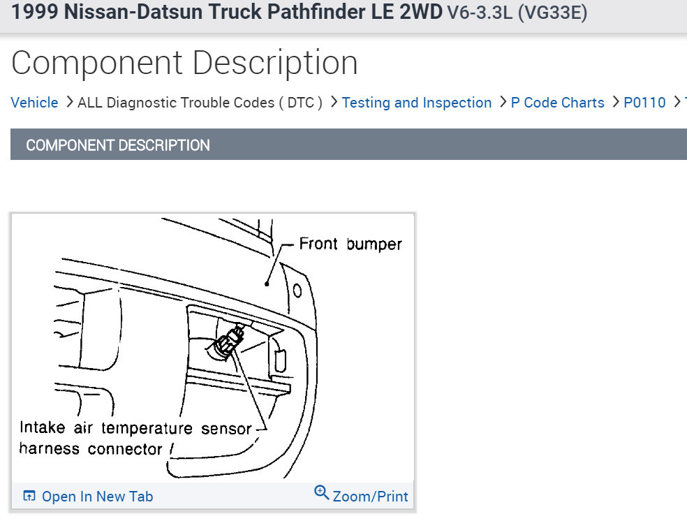

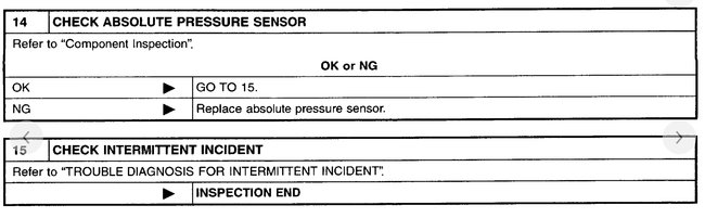

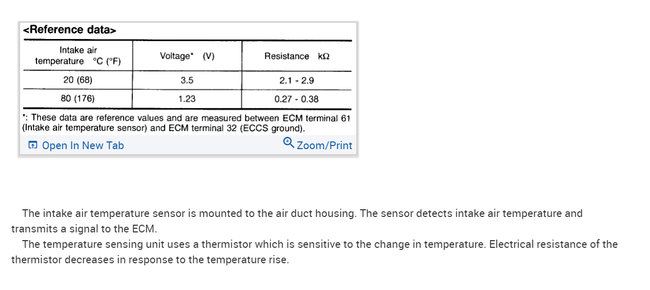

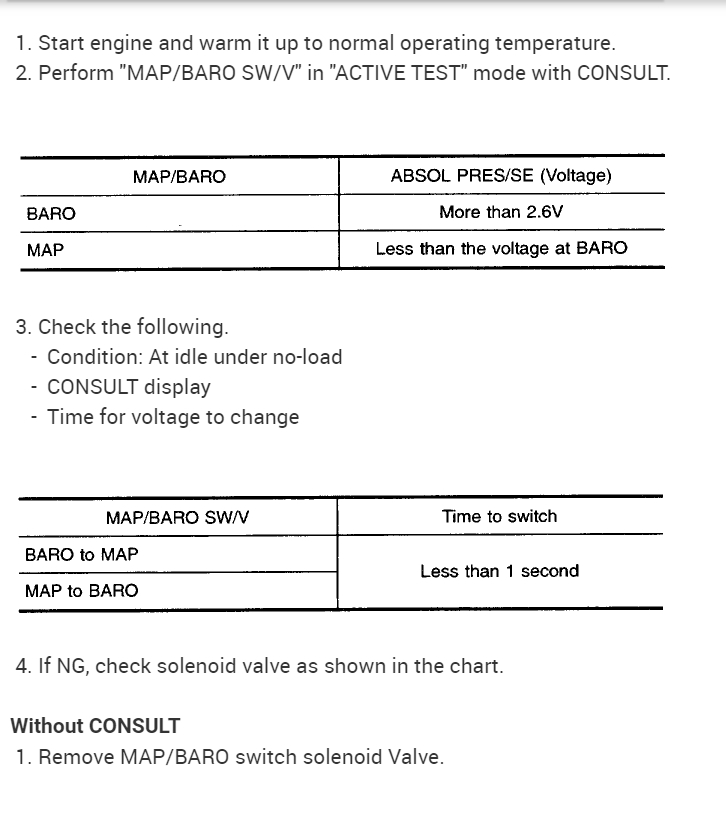

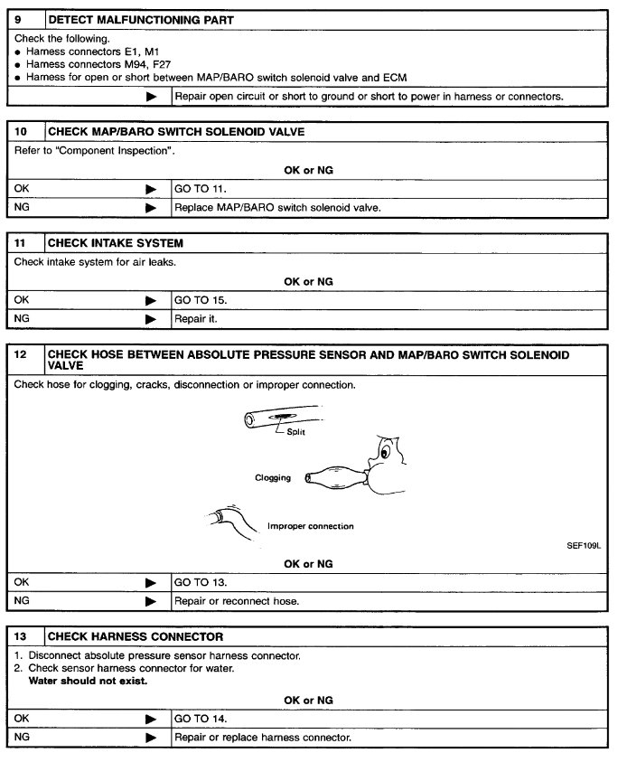

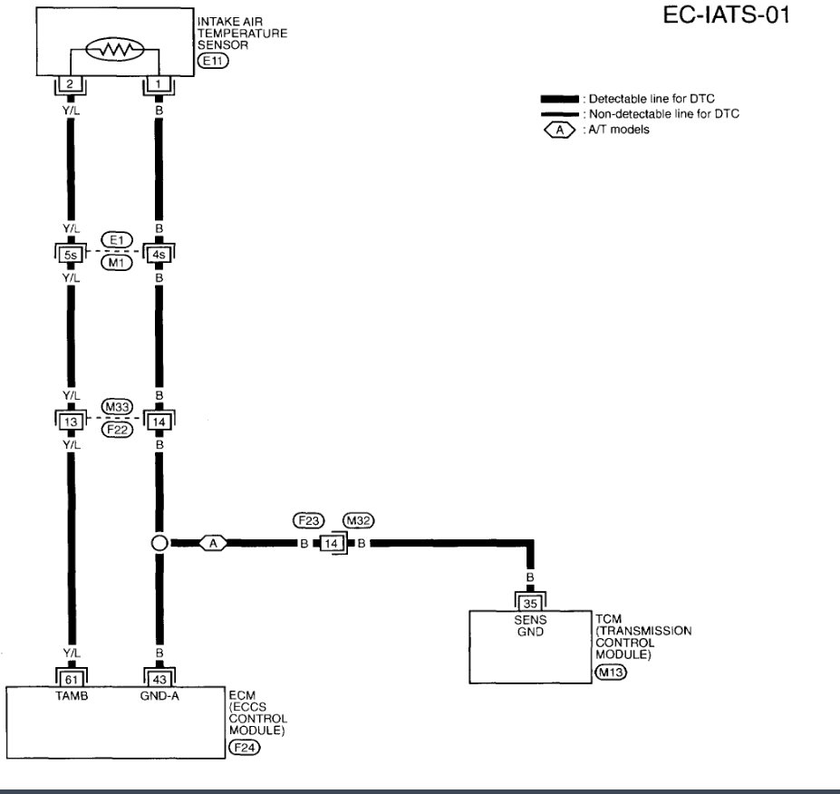

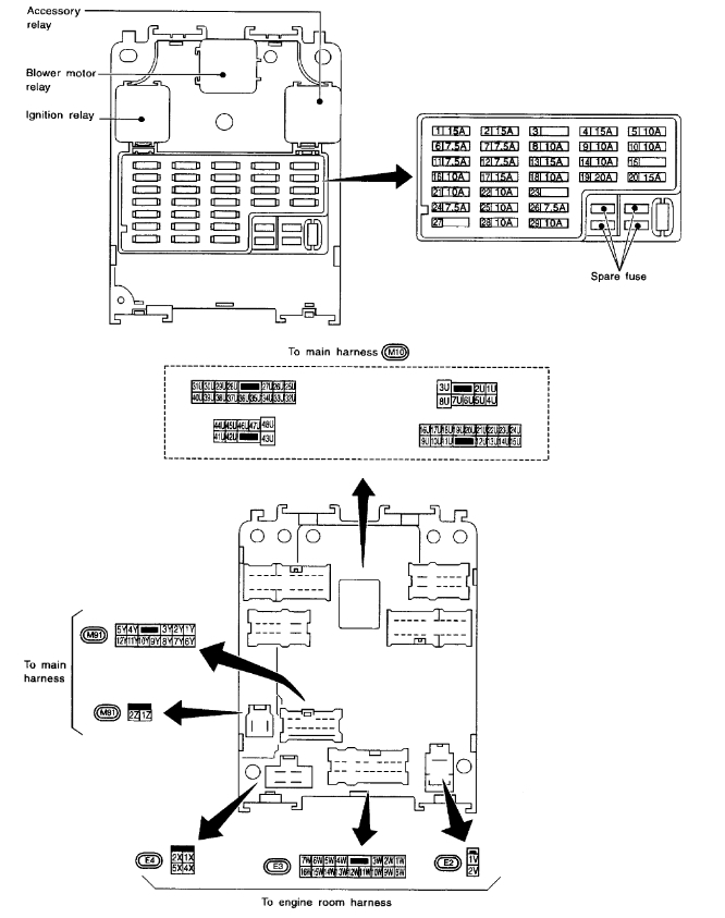

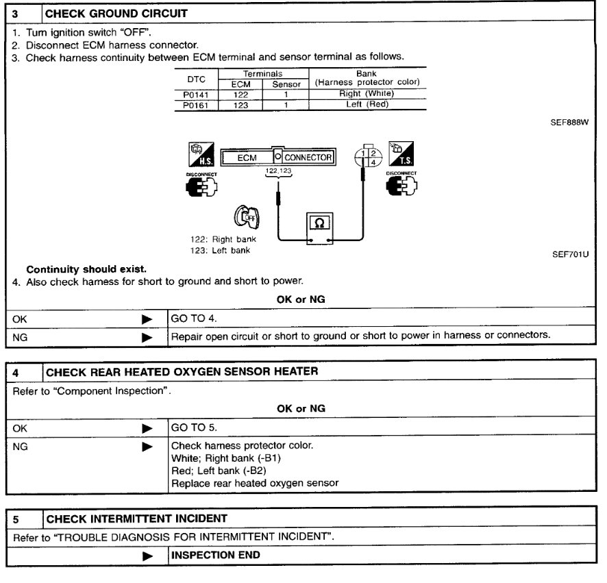

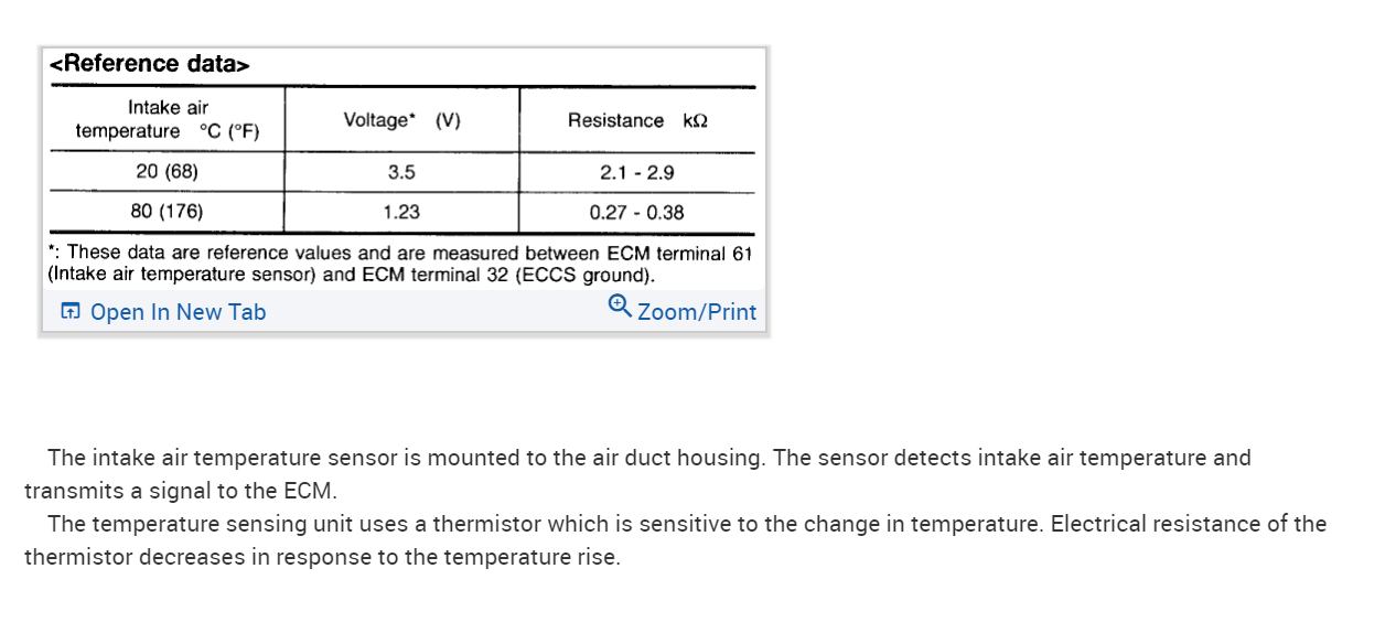

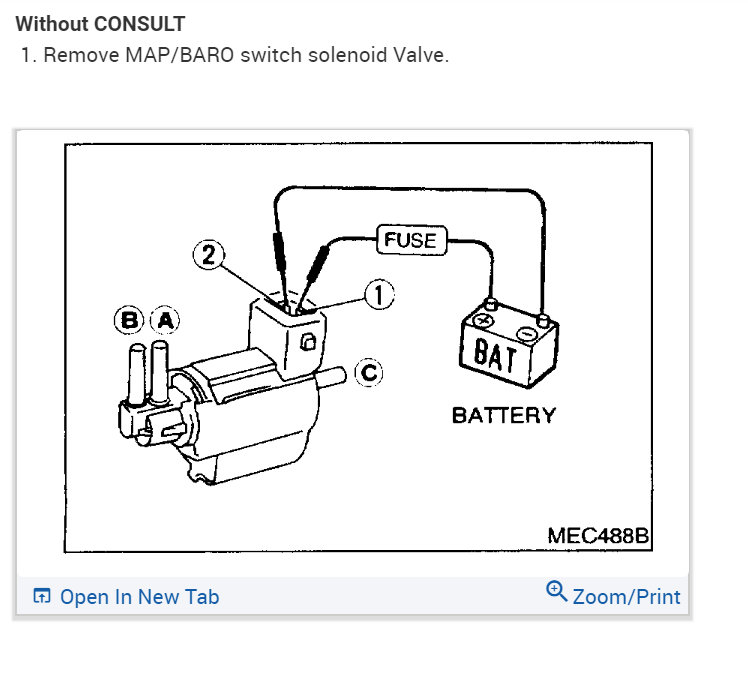

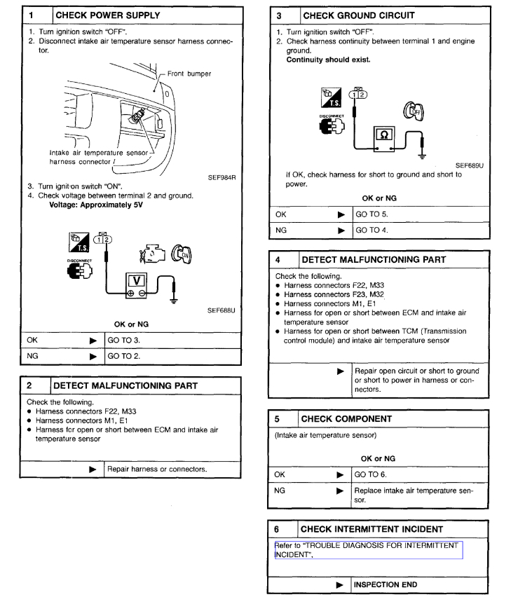

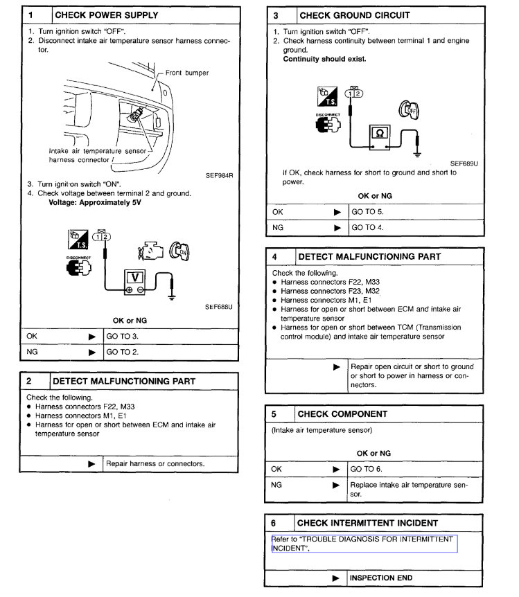

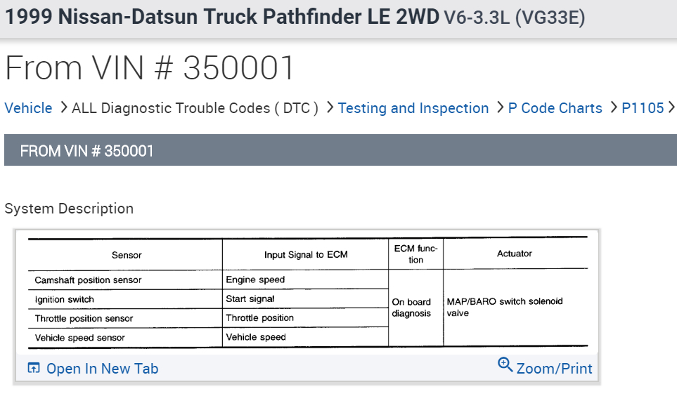

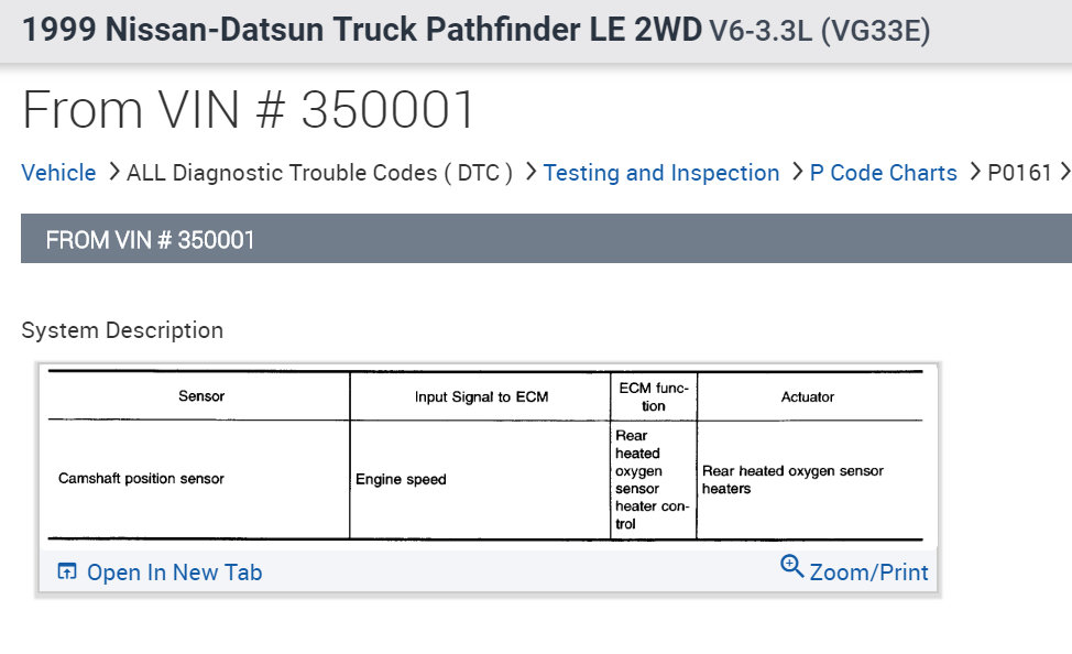

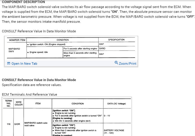

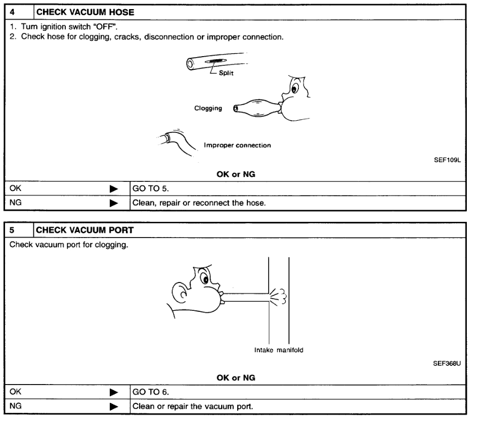

The vehicle listed above SE model. I have this codes: p0110 - p0161 - p1105. If you can send me where they are located, images or photos i will appreciate your help. Thanks. Att. Juan marin.
You can give your opinion about this, and if possible the part numbers of this sensors.
Feb 14, 2019 at 1:39 AM
SCGRANTURISMO
  • 4,897 POSTS

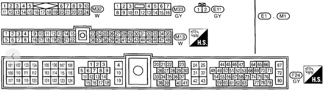

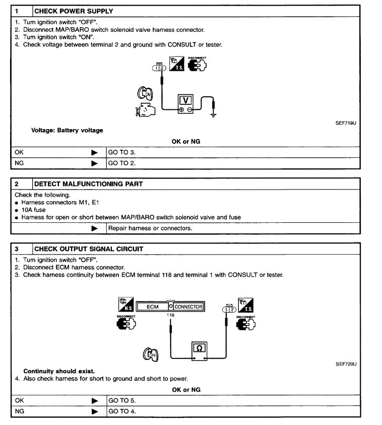

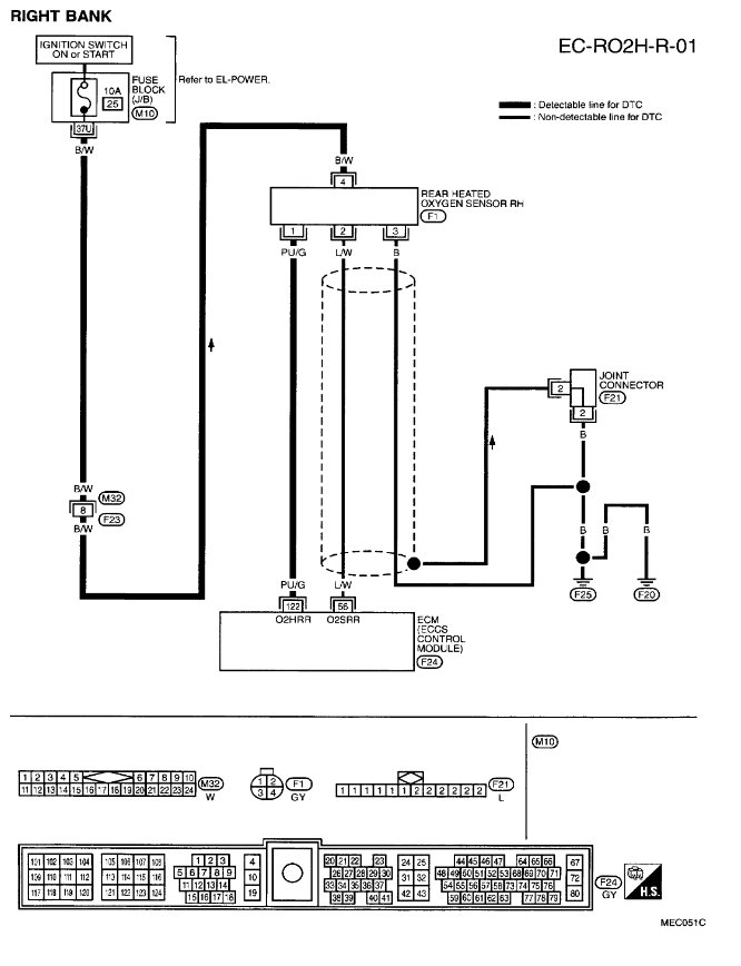

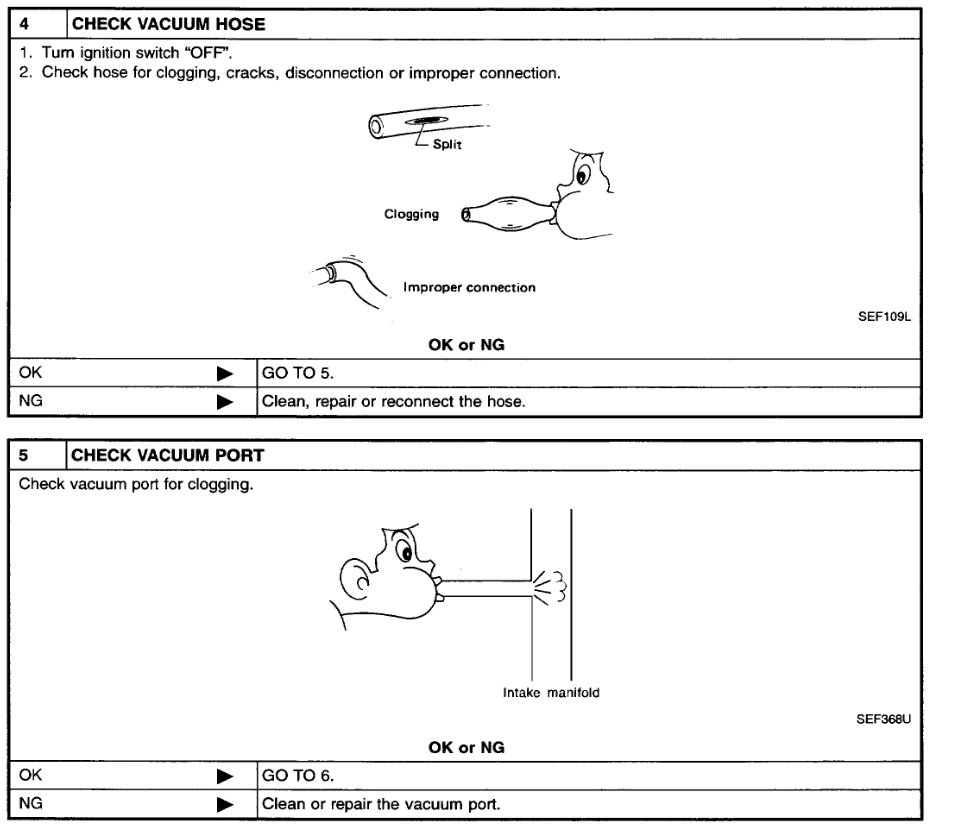

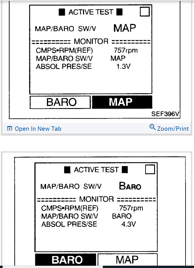

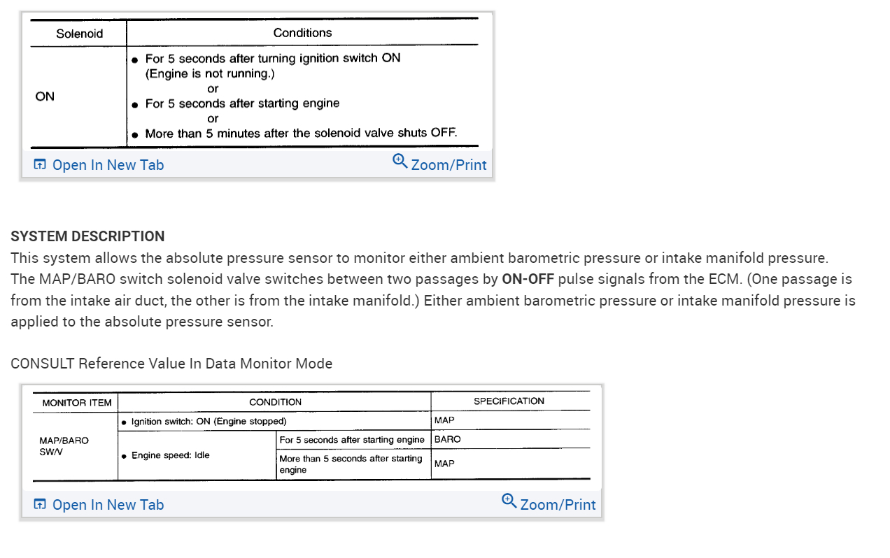

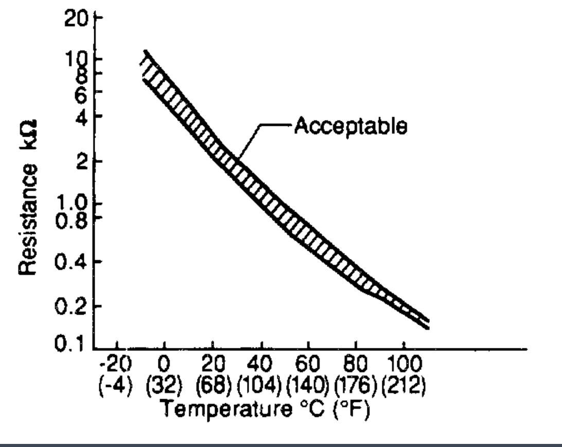

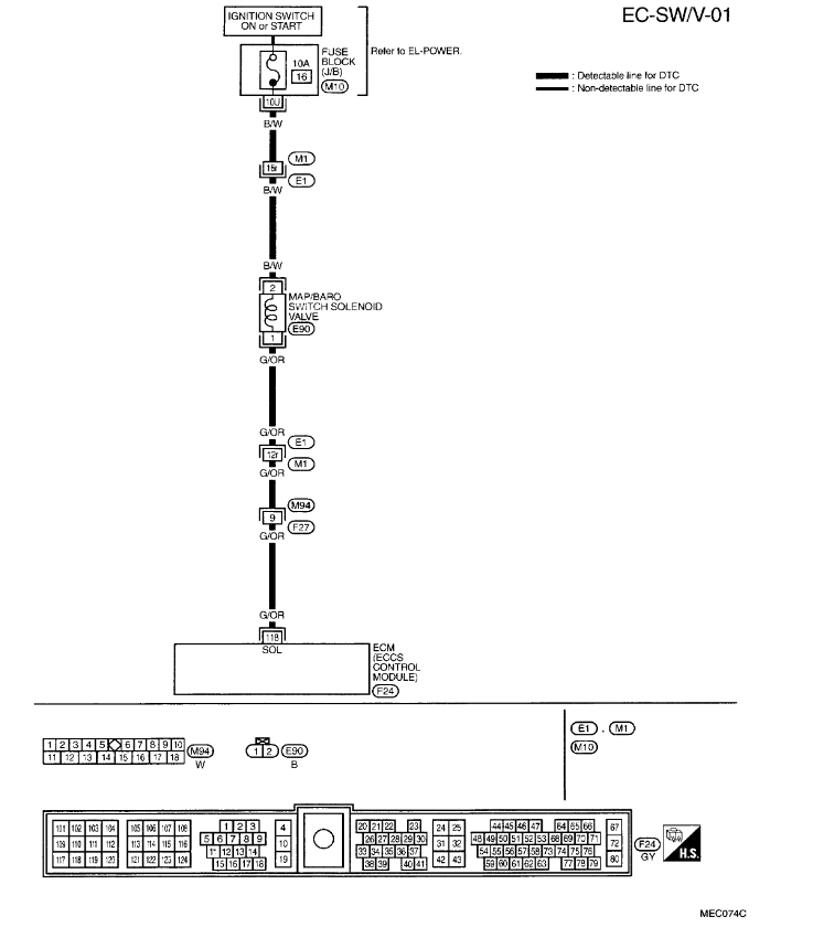

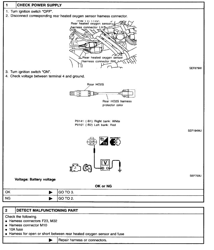

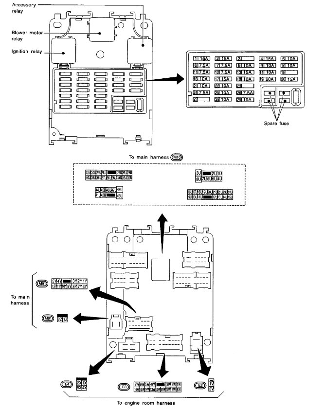

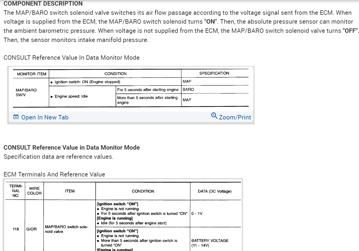

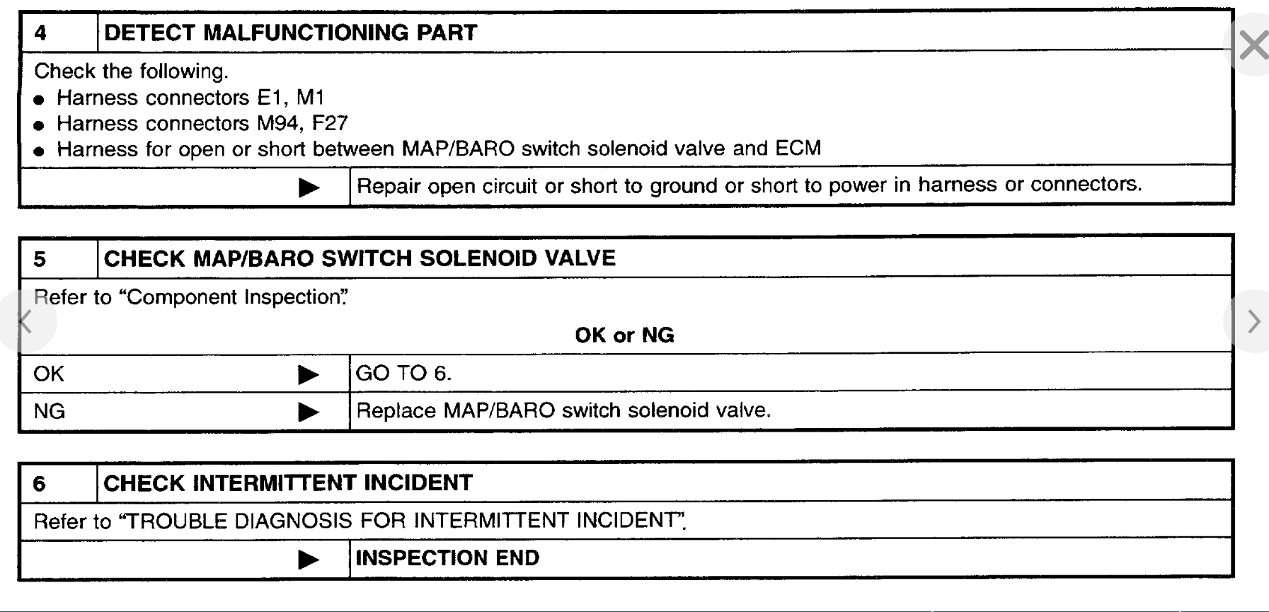

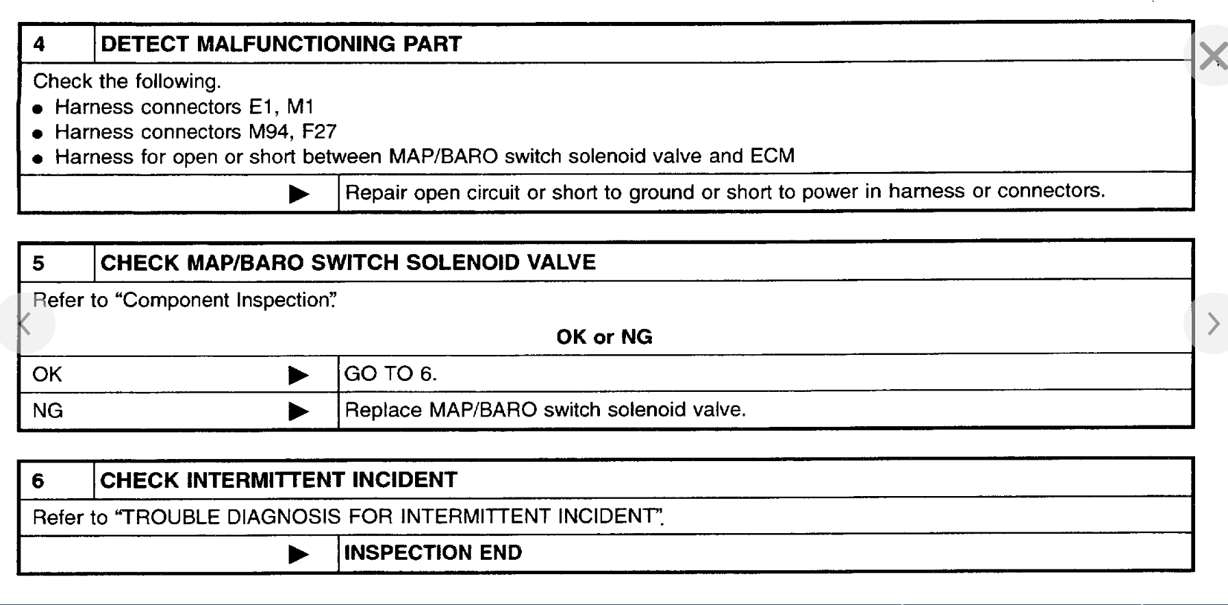

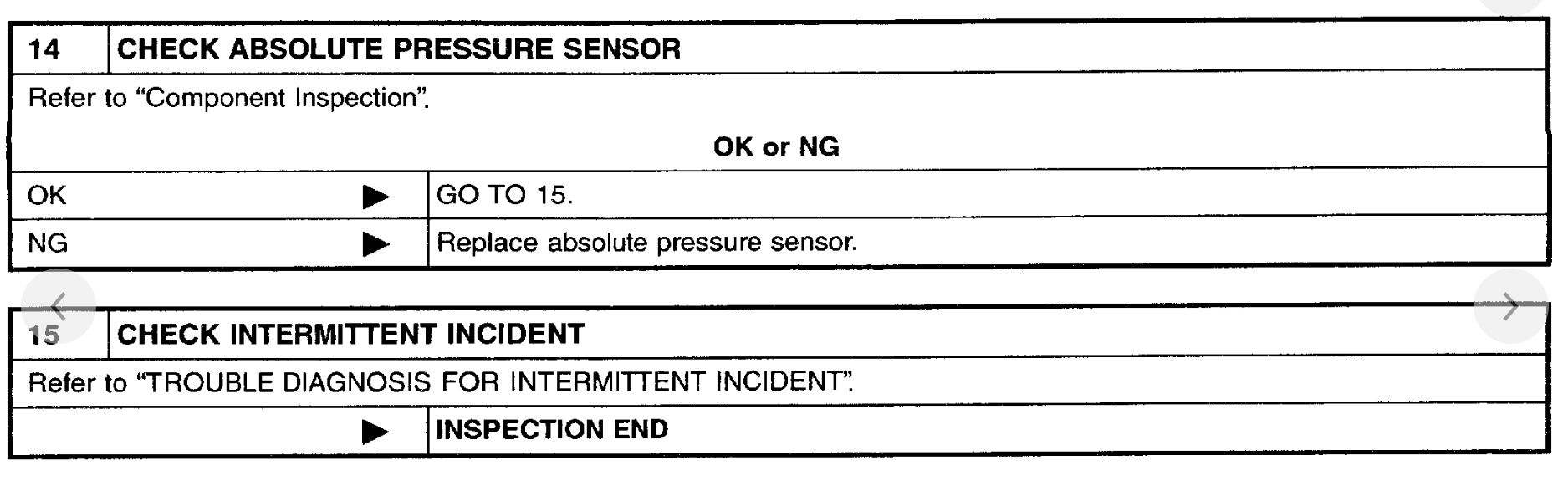

I have put descriptions, and step by step troubleshooting flowcharts in the diagrams down below for your vehicle. Please go through these troubleshooting flowcharts to find the problem for each of your Direct Trouble Codes(DTC)s. Get back to us with you find out.
Thanks,
Alex
