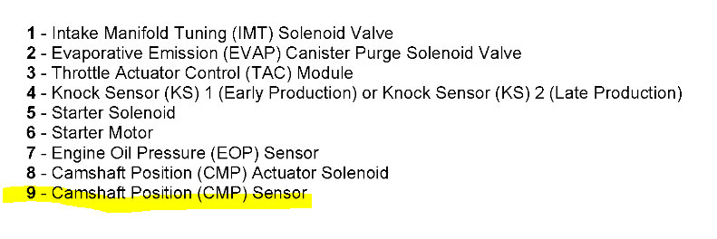

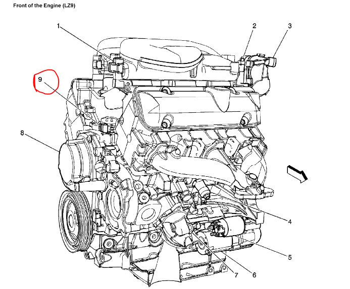

Need to know where the camshaft position sensor and crankshaft sensors are located on engine.
Nov 17, 2024 at 7:20 AM
  • 110,241 POSTS
The camshaft position sensor is located at the front of the engine, center, below the intake manifold. See pics 1 and 2 below.

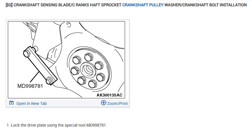

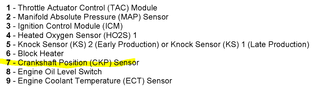

The crankshaft position sensor is located at the rear of the engine close to the firewall. See pics 3 and 4.
