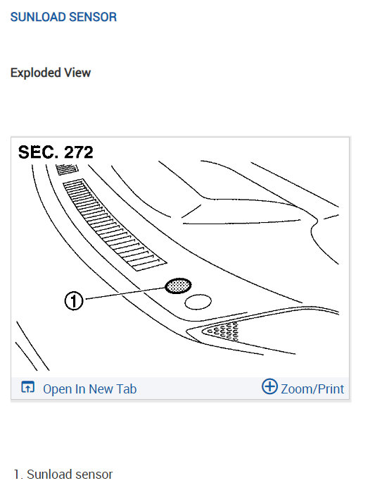

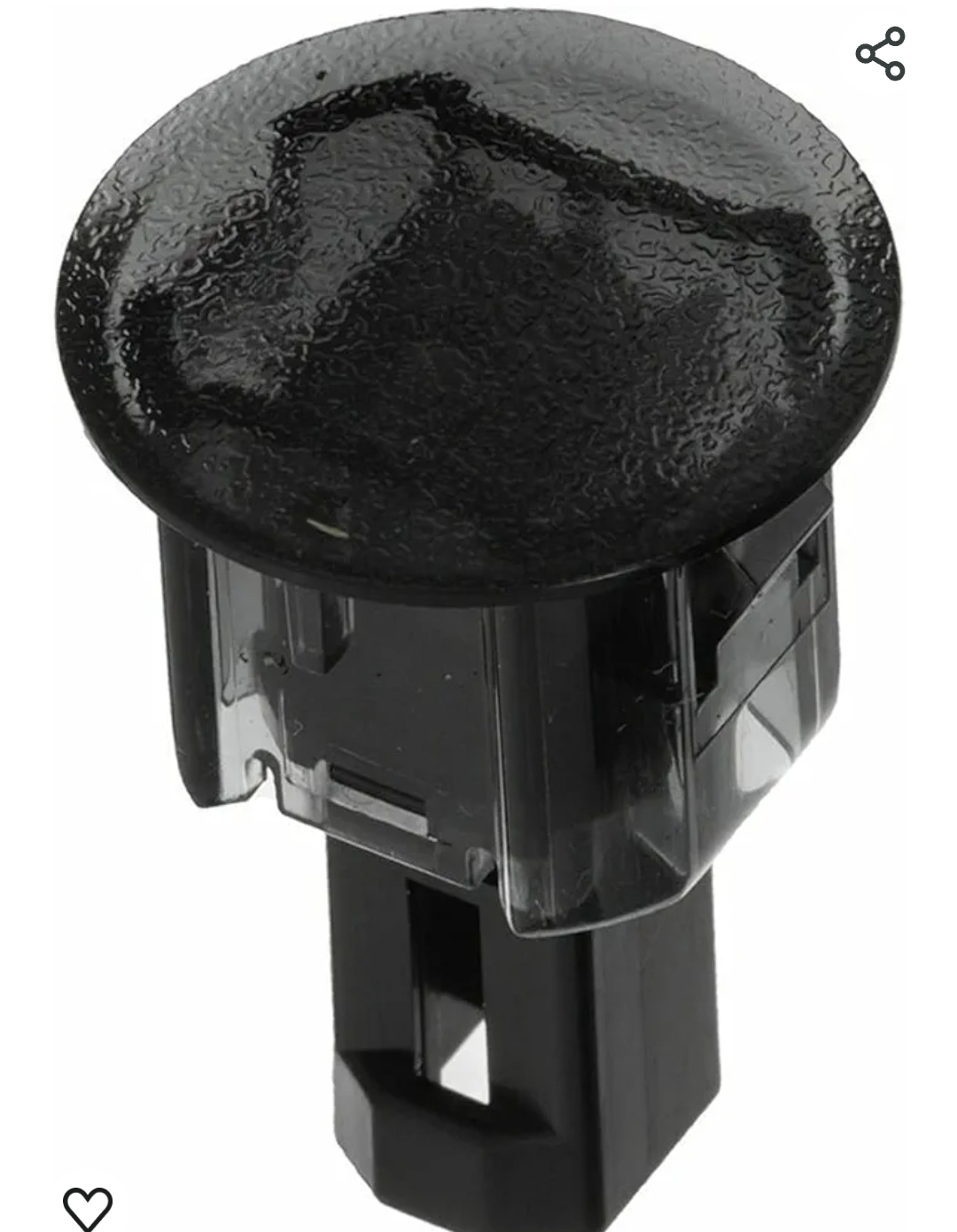

Hello i want to know if you all diagram to change out a sunload sensor.

Use a plastic trim tool and get it under the edge of the sensor and pry up. Should pop right up. Unplug the old one, plug in the new one and push it back in. Oh and it is the right hand sensor if yours has the auto light option. Check out the images (below). Let us know if you need anything else.
